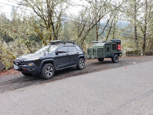

I have a 2015 Cherokee with OEM 7 pin and tow package, it will charge my trailer battery.
If the trailer battery is just wired directly to the 7 pin, it is not being charged sufficiently.
Connecting the trailer to 120VAC for charging when not in use will suffice for short trips, but when doing long duration overland trips it would be beneficial to run a DC-DC boost inverter for charging as the SUV can't provide the sufficient voltage to keep your trailer battery properly and fully charged.
Your setup might suit your needs just fine if you keep the trailer on a 120VAC maintenance charger

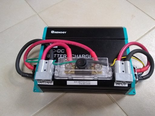

In my truck I ran 2awg from the front for both the RENOGY 40A DC to DC charger and I also use a 6500# winch on the rear tow receiver at times. 2awg is a bit light for the winch but I've been using it to haul logs, load implements onto a flatbed trailer and other tasks and haven't set the truck on fire yet! I have it protected by a 150a circuit breaker. It is near 10 years old and has been used on two trucks. This 2018 gasser and a 2006 Dodge diesel. Same wire transplanted from the 06 to the 18.
In the Toyota Venza with a 150a alternator and a much shorter run, I went with 4awg for the RENOGY DC to DC Charger.
I have a AiLi battery meter on my portable battery box that I charge from both vehicles using Anderson Plugs to connect. I've seen as much as 38amps going into the battery on both vehicles and after 20 minutes or so the wires are not even warm.
I'm loving the RENOGY as I don't carry a generator any longer. If my solar can't keep up with the 100Ah AGM in the battery box, I simply idle the tow vehicle for 20-30 minutes or take a ride somewhere and I'm back to near full.
