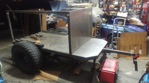

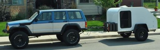

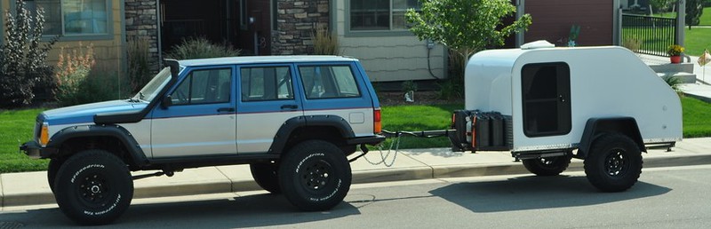

I am in the process of building one to go behind my TJ. I am torn on whether I am over doing though. The outer dimensions of the box are 48"x80"x35". The footprint is the same as my RTT and the height overall is about an inch lower than the top of my Jeep. Everything behind the water tank is on a slide to make it easier to access. I hope to have it usable in 4 weeks.20190702_215338.jpg20200528_230154.jpg20190628_202943.jpg

I am in the process of building one to go behind my TJ. I am torn on whether I am over doing though. The outer dimensions of the box are 48"x80"x35". The footprint is the same as my RTT and the height overall is about an inch lower than the top of my Jeep. Everything behind the water tank is on a slide to make it easier to access. I hope to have it usable in 4 weeks.View attachment 156688View attachment 156689View attachment 156690

I like how you padded the front box and left some room for flex and vibration...and didn't weld it, nice touch

This is a awesome build. I also have a tj and that’s what I’m building it for. I have a camper shell for a truck I was thinking of using as the main covered portion and possibly making a bed in that. It’s only me right now so it should work pretty good I’m hoping
Thanks, I wish sometimes I would have kept it simple. I hope it it is worth it in the end.
If you were replying to my trailer, the box is a 21 gallon water tank. It is at about the front of the tires so it won't vary tongue weight much full or empty.
