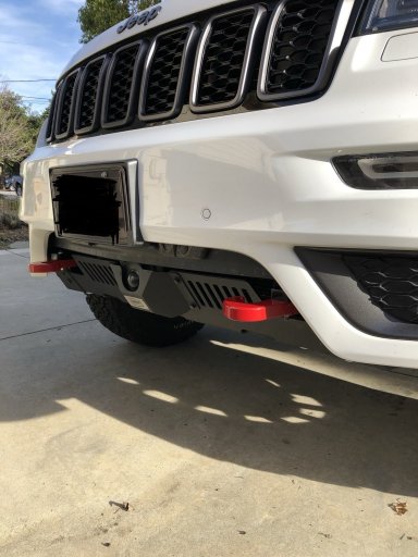

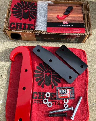

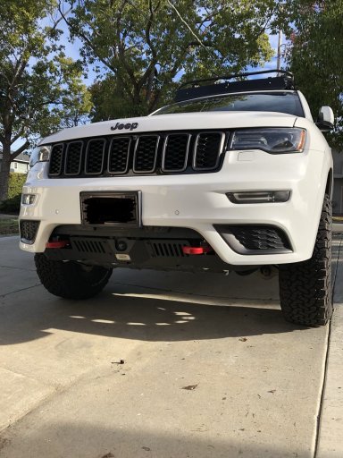

This post is a run through on the front tow hook install for anyone unsure or questioning the purchase.

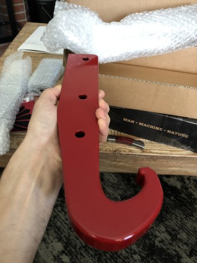

I love Chief Products and am pretty loyal to the company. I think their customer service is unprecedented along side their products. These WK2 Recovery Hooks are no exception. I feel they give a nice flare to the Jeep while also providing solid anchor points for when I help pull people out of the snow/mud (or when I get stuck- we have all been there). They also look a little different than the OEM hooks which I really like. The heaviness and build quality of these hooks is exceptional.
I wont go into detail on every step because Chief explains it very well. However some tips below may help.

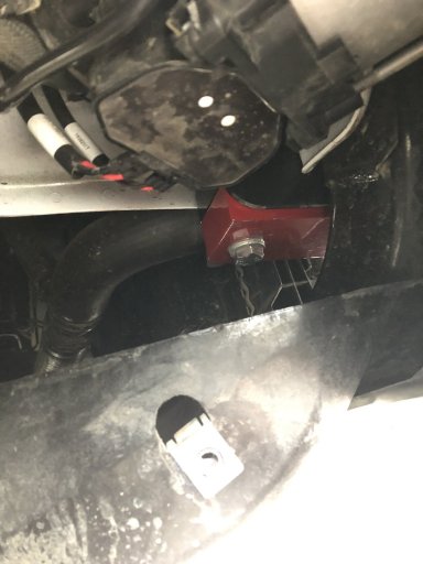

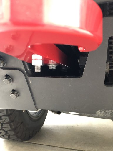

I already had my lower front guard installed awhile back, and I didn't want to remove it just to install hooks. Luckily the instructions by Chief are really good and easy to understand, and it's very doable to attach these without removing the guard. I finger tightened the front most bolt and nut together (connecting the hook and middle plate) before installing the three pieces (outermost plate as well) onto the frame. It helped keep everything together and you'd have a difficult time dropping in the front most bolt down into the hook if you installed everything underneath already. Tightening the back bolt attainable via accessing behind the wheel well cover (you only need to remove one screw at the lower end and then fold it out of the way). A simple socket set and wrench will do the trick for this quick and easy install. The hardest part (if installing with the lower front guard on already) is getting the front bolt started with your fingers into the frame- it's just a tight space.
