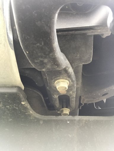

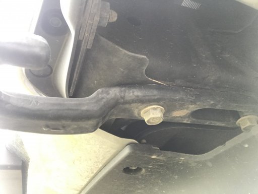

Here's a picture of the brackets. The mounting holes are slotted so should allow some "adjustment". Not sure I'd trust he hardware in that picture though.
You're not going to get much bigger than 12k for a consumer off the shelf winch. Warn make a 8 1/4 ton winch but really 12 K should be plenty for your truck. 12k is double the curb weight of a 2020 Titan for instance. And you can always add in a snatch block if you needed mo'powah (leverage)
Ok so from what i see here the difference is the arm of the mount. So on my tow hooks they are flat, where as those look like they have a dip off set. Im gonna go take a pic of my hooks.

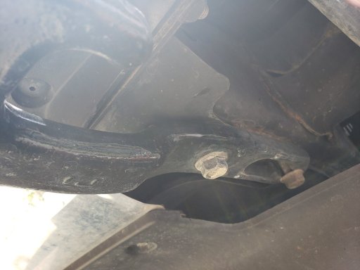

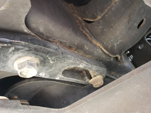

Here's my hook set up now.
ryanorr280
1,567
Stratford, OK, USA
Ryan
Orr
22140
Titan XD to hooks have a flat base where the bolts tie them to the frame. It would be a pretty simple build.
the non XD titans have a “step” in thickness of the tie hook where the bolts tie them to the frame. The hooks truly are different. As well as the way they pass through the bumper is as well.
you may be able to interchange them, however, it would require shimming them to take up free space, which wouldn’t be secure enough fir me to trust it on a recovery point. As well as not sure if the 2 bolts holding them to the frame are the same distance apart or not.

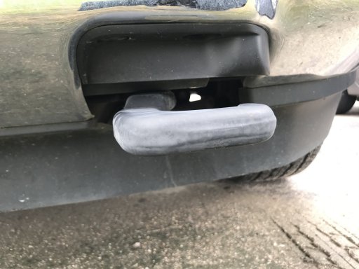

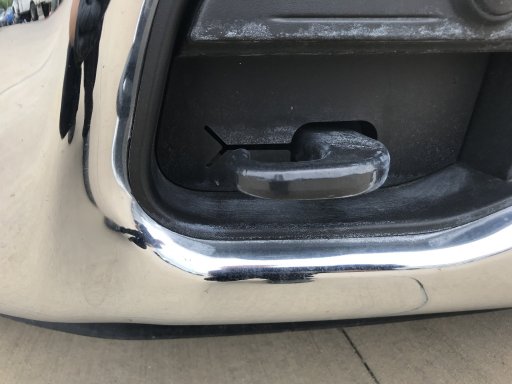

XD
Titan non XD
Reactions: Lil Bear

Yeah thats what ive come up with. Mine are flat, bolted to the frame and the bumper slot is slightly different.
