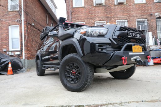

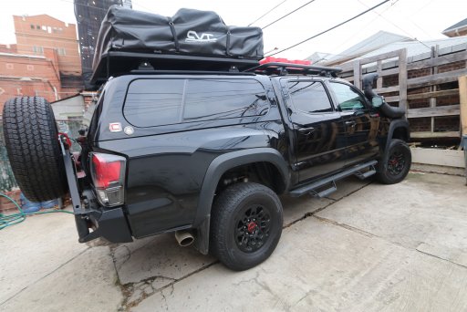

In regards to the shell. I have a rhino pioneer rack and then I have the mount Shasta cvt tent which is assembled in Canada. Then I have rhino 270 awning. I weight at 220, wife is at 125 and my duaghter is at 100. No cracks and I have put it through everything

Perfect! I think I'm sold then. Just have to find a good deal on a used topper or fork out for something new. My plan is to build a DIY unistrut rack on the topper (super strong) and run the tent that way. Thanks!
