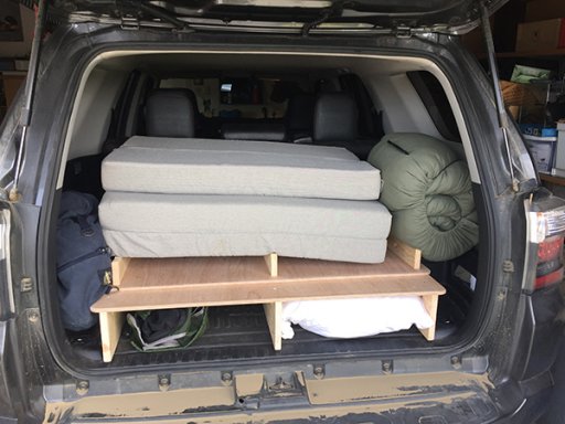

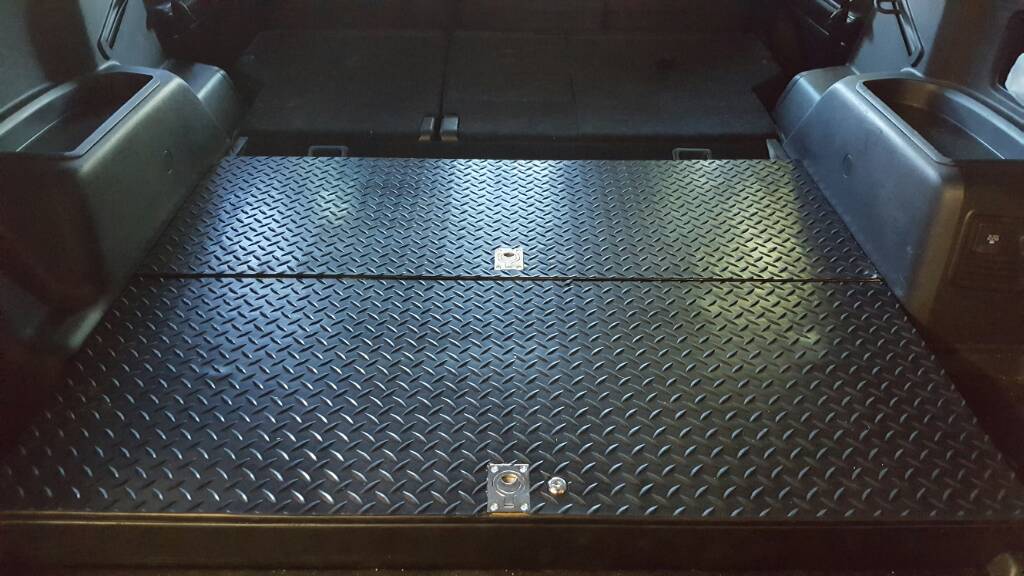

Here's some pics of my sleeping arrangement, maybe they'll give you some ideas.
The rear portion is kept in place with some shackles on the cargo D-rings. The front portion rides upside down on the back portion while in transit. I though about folding options and hinges, but this works and is simple. I usually leave the back part in even when I'm not camping and leave the front part in my garage.

Nice, clean and simple build for your needs. I like that. Since I only dream of longer trips, I won't have the larger gear and storage requirements, so the elevated compartments are not yet necessary to build. That said, I really like the slide-out with table top. Have you considered handles for the drawers? I've seen a few that use bottle openers as handles for that whole form/function thing. Oh, and that Pellegrino orange soda goes great with vodka or as a splash in tequila--or so i've heard!

Its a work in progress, handle will come some day : ) The elevated area in the back is necessary to fit over the folded down rear seats for the flat sleeping surface. It could have been maybe a half inch lower but I wanted the drawer to fit my camp stove. The space below is always really handy.

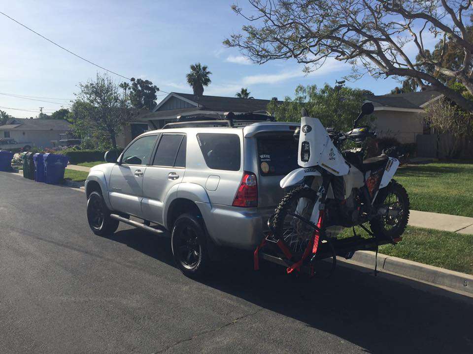

Mine's a 4th Gen, but that's essentially what I do. I've done two trips thus far (3 days and 5 days) where I've gone somewhere with my motorcycle and I just sleep in the back. After the first trip, I decided to remove the back seat bottoms (two bolts each) to give myself some more headroom (I'm 6'3"). I have an inflatable REI pad and a sleeping bag and I'm good to go. I'm pretty minimalistic when it comes to meals, etc. (from motorcycle camping for so many years). I bring a Jet Boil, a few boil in bag meals, and some Starbucks vias and that's most of what I need for food. I have a small soft-side cooler for the beers. Everything stays inside with me at night or goes on the roof.
This was from this past weekend:

What's on your roof rack, or is that an optical illusion of something behind the 4R?

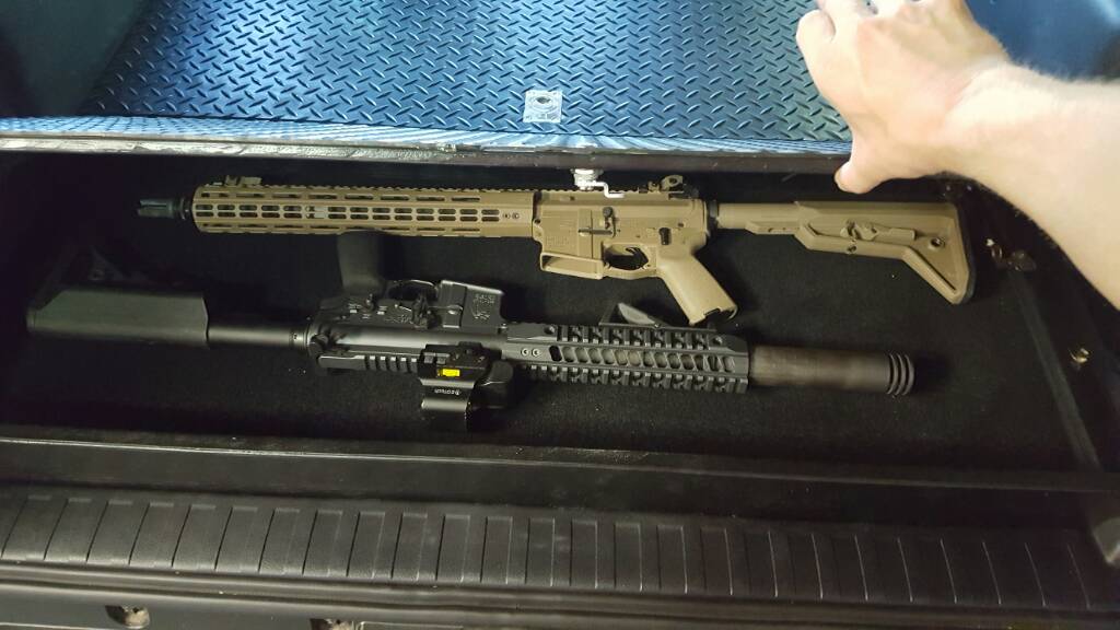

@SAFETYRUNNER Thanks for the idea! I've been thinking about this since you mentioned it. Friday night I looked around on Amazon and found one I figured would work out well. It arrived at 8:00 this (Sunday) morning! I think it turned out pretty well for almost zero effort!
