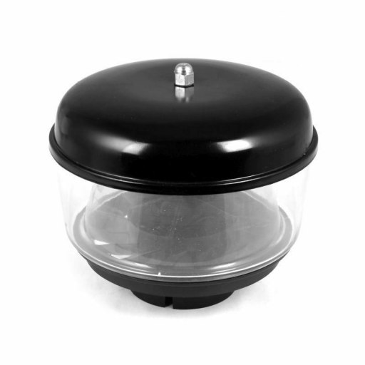

Ulysses said:
.... I use these dust covers for sections where there’s a fair bit of bull dust. 4x4 Pre-Cleaners
They do a good job but be sure to limit use I.e. not designed for permanent use
Or, use something like this
So cool, and a low restriction protection option. I have used a OMNI foam filter for years on a Suzuki King Quad, and years ago on a carbonated Ford 6 cylinder pickup.
My preference has always been oiled foam over oiled gauze. I like this over a cotton cover, as it is washable, and the oil will hold the dust that is encountered. If I had a snorkeled vehicle, and lived where dust was often encountered, this would be a viable option.
The link provided above is the first I have seen of a option like that... again, really cool.

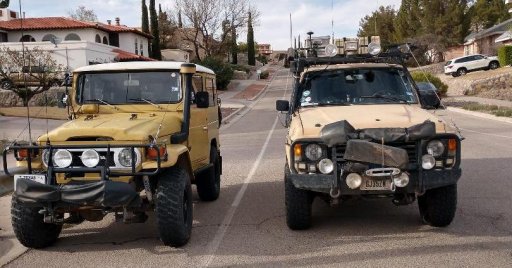

mep1811
1,212
El Paso, Texas
Perez
I have snorkels on both my FJ-60 and FJ-40 . Both have pre-cleaners which is the real benefit of the snorkel in a dusty desert environment. Brothers2.jpg
