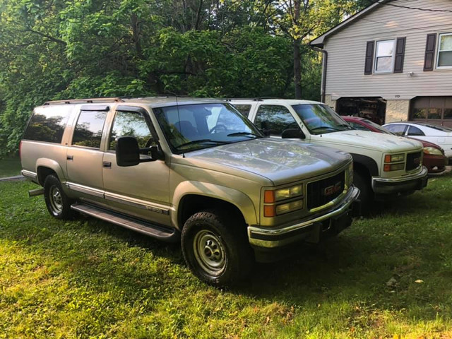

Parked next to Dads 99 K1500 Suburban 5.7, which is the truck I learned to drive in, and has since been passed on to my brother as Dad upgraded to an 03 C2500 Suburban.
Couldn't believe how well this body cleans up and how straight it is!

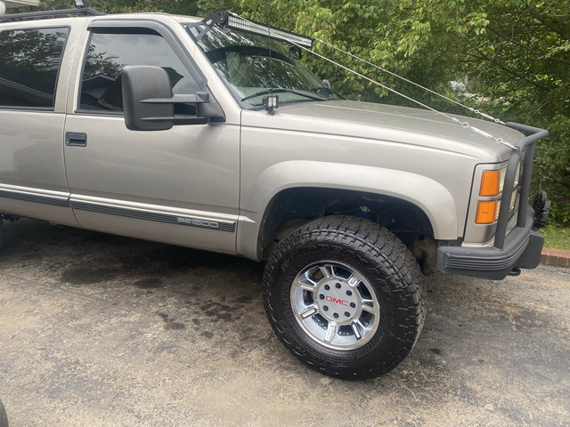

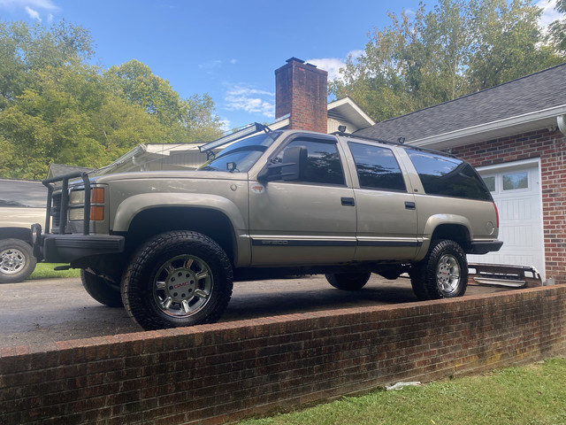

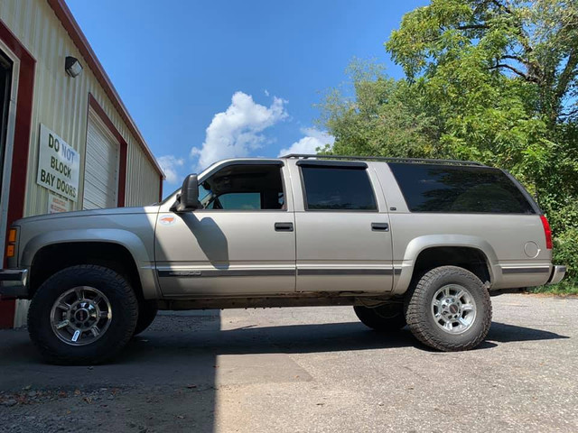

And of course we had to upgrade the wheels and tires. Some 285/70R17 Falken Wildpeak AT3W 10 ply tires wrapped around some H2 wheels.
Removed the sidesteps and the valence for a more aggresive look, better approach angle, and more ground clearance.

Added a little lift, front and rear.

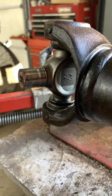

Then moved on to the front U-Joints, simple enough job with the crossover pipe out of the way and the right tools.

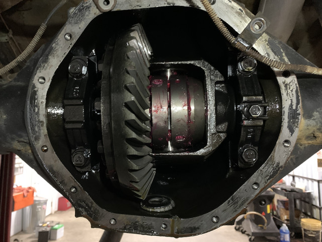

Got all the open diff junk out and the new PowerTrax Lock-Right locker in.

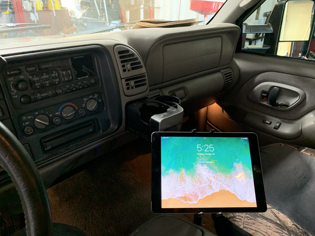

Got my tablet mount in today and installed it after work.
Removed the center console and seat to inspect under the carpet before mounting the base.
Installed and holding the iPad. Pretty happy with the location. It's definitely not the most sturdy but for $30 I sure won't be complaining about it.

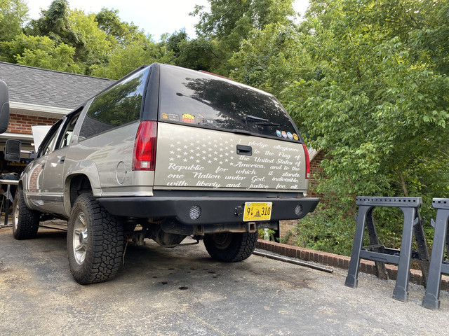

Spent a few weekends fabricating a new rear bumper (Still in progress on that, would like to add a swinging tire carrier for a new full size spare), a simple brush guard for the front bumper with a little trimming and limb risers, and a little bed liner.

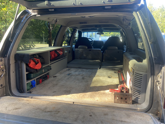

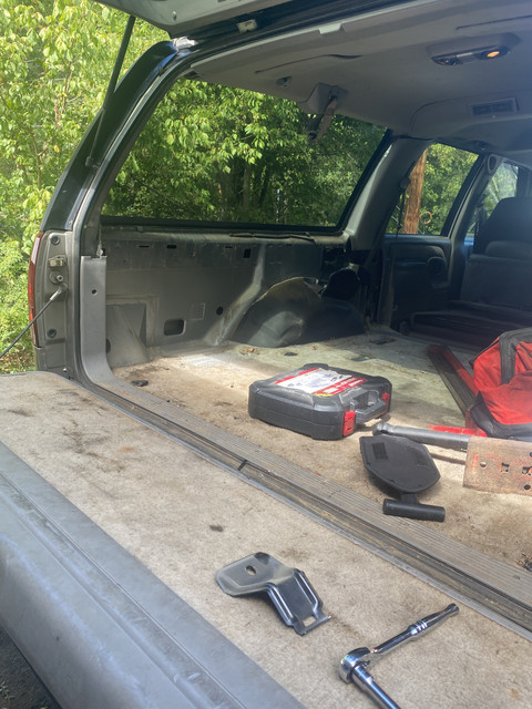

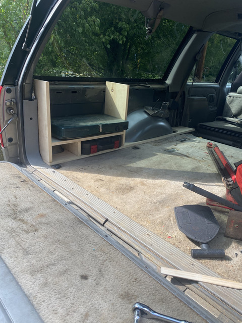

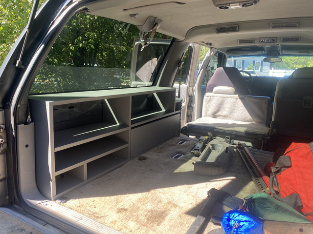

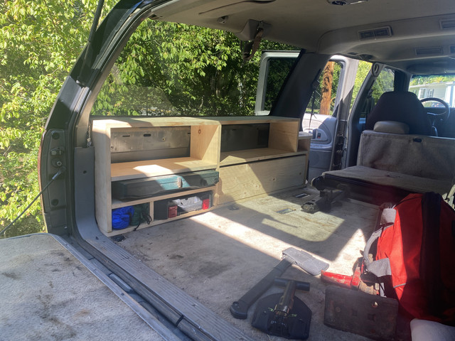

And finally, this past weekend I got a chance to tear out the old jack storage box and spare tire set up and replace it with some dedicated storage!
I think that's everything that was somewhat important to catch us up from my last post, with any luck I will be more active on the outfitting of this truck and bringing the results right back to you here!
