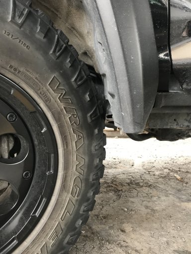

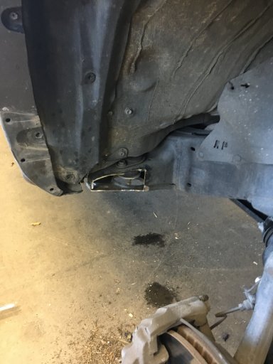

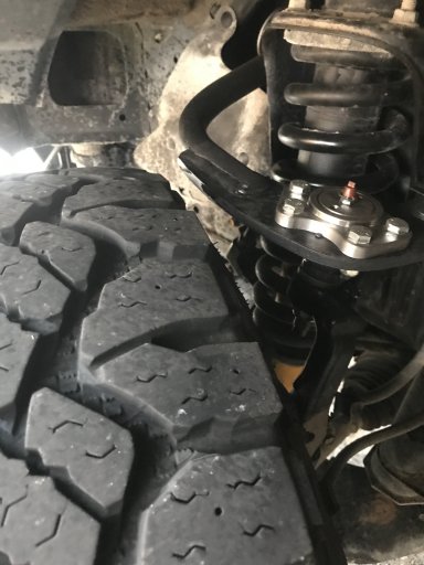

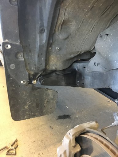

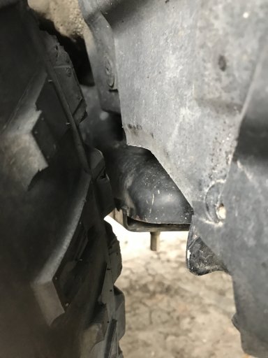

Hopefully these pictures better illustrate the rubbing issue that I'm having and my concern for when the suspension is fully flexed. It doesn't seem like I need a ton of space.IMG_8457.JPG IMG_8456.JPG IMG_8458.JPG

That's your cab mount. You won't be fixing that with a hammer. It need to be trimmed back and have a plate welded back in. Pretty common for 285's and up.
