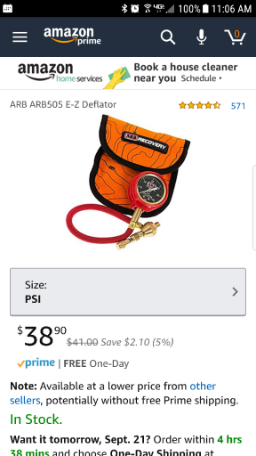

It looks like there is a button on the side you could use to release air but it would be a pretty slow process I would imagine. I have this for deflating and it is amazing. Screenshot_20170920-110619.png

I have the Currie version of that one, was cheaper at the time, and love it. You just have to make sure you get the tire valve all the way off/unscrewed or else it will not work that great.

I've tried several kinds. The kind you screw on individually for all 4 tires work pretty well but they can get knocked off your setting somewhat easily (in my experience) and most of them are somewhat of a pain to initially set up. They aren't consistently accurate either. The best system I have found is the ARB. They air down fast and accurate and are quick to put on after you do it a time or two. I found that I could do all 4 tires with the ARB in about the same or less time than others using the individual deflators (you still have to go to all for tires and put them on and then wait for them to do their thing).

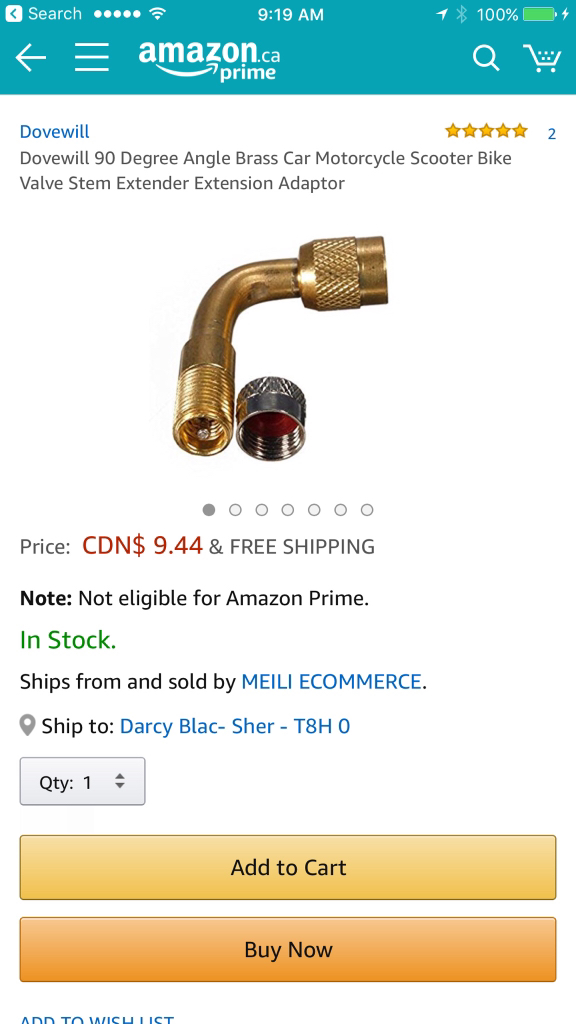

I use a valve stem extender and remove the valve from it for airing down. As the tire airs down a pressure gauge still works on the stem. When you hit the right pressure just screw it off.

I'll cast another vote for the ARB deflator. You'll find cheaper units but these are the best I've used. I'll bet I've cycled my Jeeps tires with the Arb deflator a good 30 times with no signs of wear.

I have both the Staun and the ARB deflator. The Stauns are nice because you can put them on let them do the work but the downside is they are set to just one pressure... and that pressure is not always accurate. Some folks adjust one pair to one pressure and the other pair to another pressure.
I use the ARB deflator more but you have to tend to it... while the air bleed screams in your ear. I'm not completely happy with either devices.
