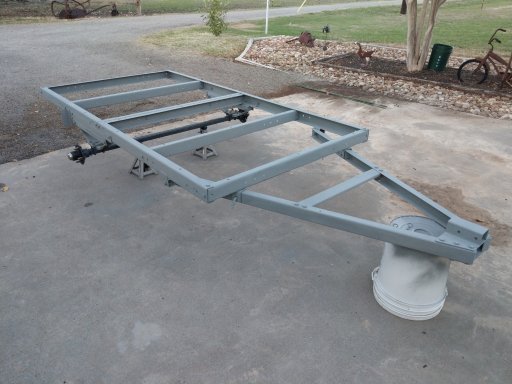

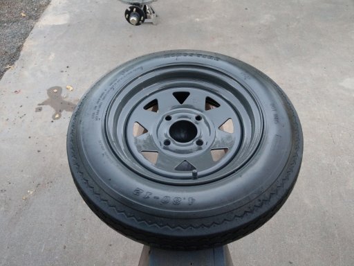

Power washed, sanded, and primed the (M)Ikea trailer frame. Also, changed the wheels color from white to charcoal gray.

Argh! It's been raining every day since the day after I primed the frame. :rage:
