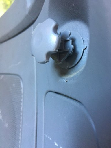

the Sub is in the passenger rear and the deck, carpet, pad, molding, seatbelt, and door sill had to be removed since the ENTIRE panel had to come out. It looked like it sectioned out where the sub is. Don’t be fooled. It rivet melted in the back. These little bastards were a pain in the ass because they aren’t removed by any logical reasoning.
They pop out if you can manage to catch the tiny lip that separates the plug from the base
