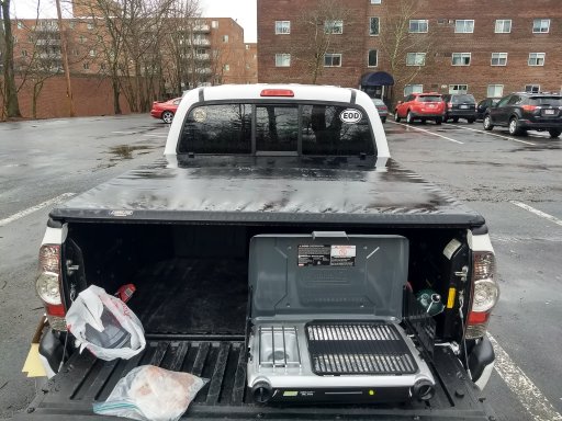

Tryed out my new Grill/Stove today. I realized I need awning for when it rains. I'm pretty minimalist as you can see. I'm actually planning on keeping my truck stock besides adding some sliders but I'd like to see how far I can push my setup and myself with very little.
I'd like to make an awning out of a tarp. I have buckles on the tonneau cover so I would attach a side of the tarp to by attaching buckles to the tarp somehow. And my current plan is to have the other side held up by 2 tent poles. Basically the tarp would extend from the front of the bed of the truck to the tent poles setup behind the tailgate. Any recommendations or tips? Has anyone done this before? What tent poles should I use? Thanks in advance

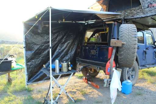

Built my own this year to cover the kitchen area of the jeep when traveling. I carry extra tarps to enclose the area in really inclement weather. The poles and tarp
all roll up in them self. I use Velcro straps now when its rolled up. They stand up better to the sun. I used 4 tent poles, and Galvanized electrical conduit . a few stakes and some para cord and it will stand up to most winds.

That is a very nice setup. Do the sides flap in the wind while extended or does the picture not show the ties at the grommets? What size tarp did you use and did you cut it down to fit?
