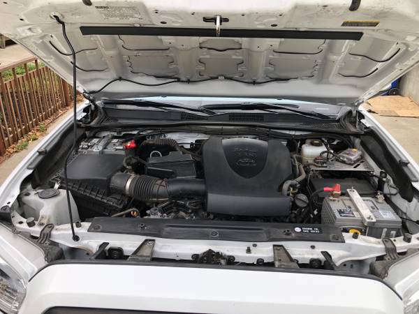

For sale is a dual battery kit by off grid engineering + 2 North Star Group 35 batteries.
As far as I know this only fits the 3rd gen Tacoma’s . I just remived 2019 Tacoma trd offroad.
This kit is amazing , works soo well and great if you plan to hook up extra accessories to your truck.
I am only selling it because I’m trading in my truck to the dealer and they want it off.
Thanks for looking!
Thanks for looking!
Hey, if you end up breaking up the setup, I would take the aux tray in a sec.
FYI, this setup is actually for a 2nd gen. Reason being, 3rd gen tacos have an alternator voltage that's regulated/limited by the ECU. The max volts you get from the alt on the newer trucks is 13.5. you need ~14.4v to fully charge a deep cycle. On the 2nd gens the alternator volts matches the draw. The Blue Sea AC relay works great for those but the newer trucks need a DC-DC charger like the Redarc unless you want to top off the batteries every few weeks. With that setup you actually keep the stock battery or a non deep cycle as your starting batt and the wiring doesn't need to be a heavy gauge.
Sorry just thought you might want to know that for your ad.
Thanks , won’t be breaking up the set as then it wouldn’t be worth anything. But I actually bought from off grid engineering and they advertise it for the 3rd gen Tacoma and recommend these northstar batteries. I have no idea if these battery trays fit a 2nd gen or not. The 3rd gen literally has a 2nd battery location , this kit Bolts right up .
I ran it for about a year and it worked great so no idea the real math behind it but you sound like you know your stuff ;)
Yeah I know they have it listed on their site that way but the owner confirmed the same thing when I asked him about it on the phone last fall.
Best Graham
