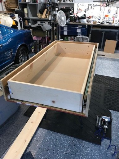

Looks good. Is that 3/4 inch plywood for the top and sides? Does that seem thick enough/too thick? I have most of the hardware for my own build and will be getting the wood soon.
PaulieBlueTaco
Waldorf, Maryland
10866
Yes it is 3/4 and it is strong enough to lay on and I am 210lbs. does not bow at all. The other parts are 3/4 pine and the bottom of the box is just 3/4 particle board to cut down on the weight.

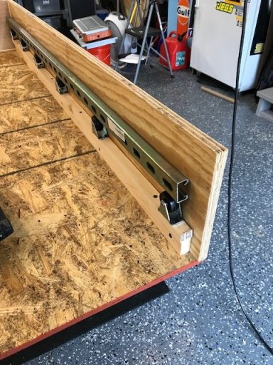

Good work! I like how you’ve incorporated a unistrut, looks solid.
I’m building a platform and drawers for my taco as well and went with 1/2” plywood and my reference point is the ‘shelf’ on the sides - wheelwells and I have no flex when I’m on it and I weigh 195 lbs.

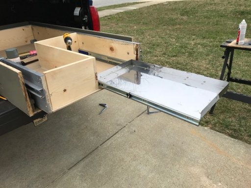

interesting slide design... did you price out using the skate board bearings before going with the castors?
