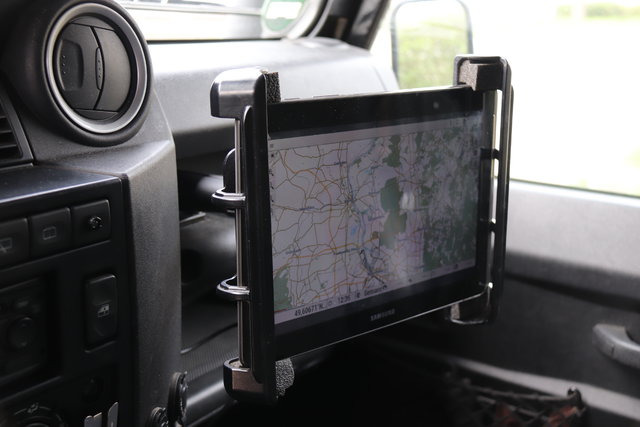

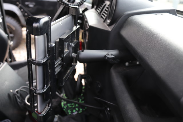

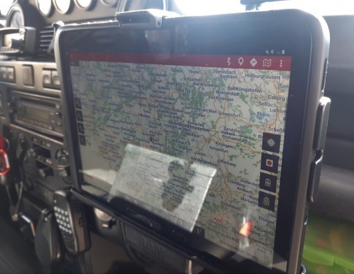

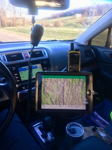

I have had a Samsung Galaxy Tab 10 inch in a RAM MOUNTS Universal Tab-Tite holder for 10 inch tablets in my vehicle for years. Mounted using B size ball ground plate and double socket arm. Just bolted the ground plate to an asolid anchor point in the cockpit. I have been very pleased with the solution. The tablet was super tight in it even when the route was getting rough. First with an Otterbox around the tablet. When this was older and the rubberframe was not so good anymore, I used it still about 50,000km or 30,000miles without cover in the holder. Worked also perfectly. Without the Otterbox the holder was then a bit too big, I padded it with foam, simple and good.
So, when I got my new Samsung Galaxy Tab Active Pro last year, with which I am very satisfied (I have described elsewhere here already), I only exchanged the holder for the tablet. After the good experiences of course again a RAM MOUNTS holder. This time the special Power & Data Dock for the Samsung Galaxy Tab Active Pro. That one is really again another improvement to the universal holder Tab-Tite. The tablet holds perfectly, even on rougher routes. Charging and data port integrated. I like it very much and I am looking forward how it works on long-distance overlanding travel, as soon as it starts again! I like to report! I have currently no photo of that setup. Will take a photoshot the next days and upload it here if you like.
For me this setup works so perfectly and it is worth the money to me, someone else is maybe satisfied with another, simpler solution. As always, we can only exchange experiences here. Feel free to ask if you have further questions about the setup.

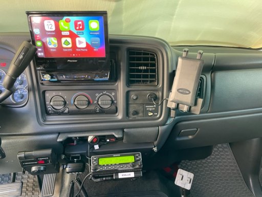

I got this seat mount for my iPad mini - Amazon.com: Arkon Mounts TAB188L22 Car or Truck Seat Rail or Floor Tablet Mount with 22 inch Arm Retail Black: Computers & Accessories. See bottom right of picture. It looks low, but when mount attached, it looks fine. I could use additional mounting C clip with mine because I have no place to attach it to. That C clip would make it more stable.
How the flexible stalk with regards to stability? Does it shake much?

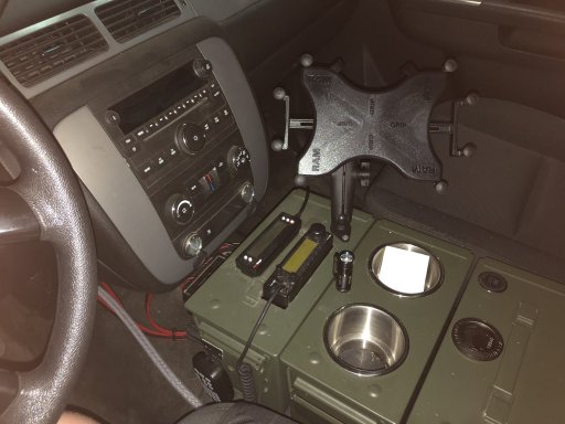

I used an X grip for my iPad.
Love the ammo can center console. That's a great idea that also looks awesome!
There's two designs of X Grip tablet mount. The one @TahoePPV shows, in my opinion is the better one. I've run that one for several years now.

I haven't taken it off road enough to tell, but on the streets and highway I don't notice it moving. However, if I was able to attach the 'c' clip to something solid, then it would be very stable. Using the touch screen is ok, requires some finesse while rig is moving.

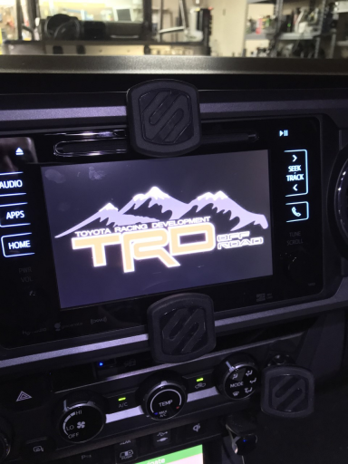

I use two Scosche flush magnetic mounts on a homemade bracket for my 10" tablet. I also use one for my phone. They have held great.
This isn't my picture but the one that gave me the idea. I don't know what your dash looks like or how you feel about covering up your radio controls or whatever but it makes for a clean mount when the tablet is not mounted.

I like
I like the directness of your setup, but my dash isn't really conducive to this. The passenger air bag forces the mount much more towards the center of the dash where it blocks the HVAC controls and radio controls, although I can probable get it low enough to clear the radio, but then access to the cup holders and my phone mount are impeded.
Thanks. Understand. And of course, all other cockpit/vehicle functions must continue to work properly. This is especially the case for safety-related things. Sometimes I see vehicles where accessories are mounted in front of the hazard light switch or similar - this is absolutely wrong and should never be done in my opinion!

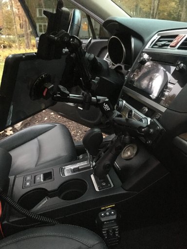

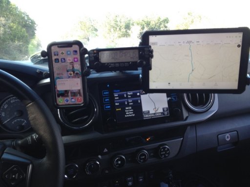

Since it’s a Taco I’m surprised there isn’t a well established solution but custom can be better anyway. I’d recommend keeping it out of your windshield so you don’t impact visibility and I’d also recommend a 2nd mounting point for stability. I went through 3 iterations before setting on this and despite the weight it’s rock solid off road, doesn’t impact my visibility, and everything else is accessible/functional. The best thing about Ram, and similar products, is that the options are limitless. Get creative and please share what you end up with @ptgarcia
