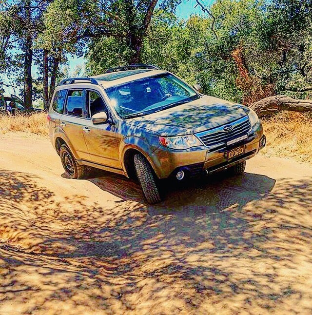

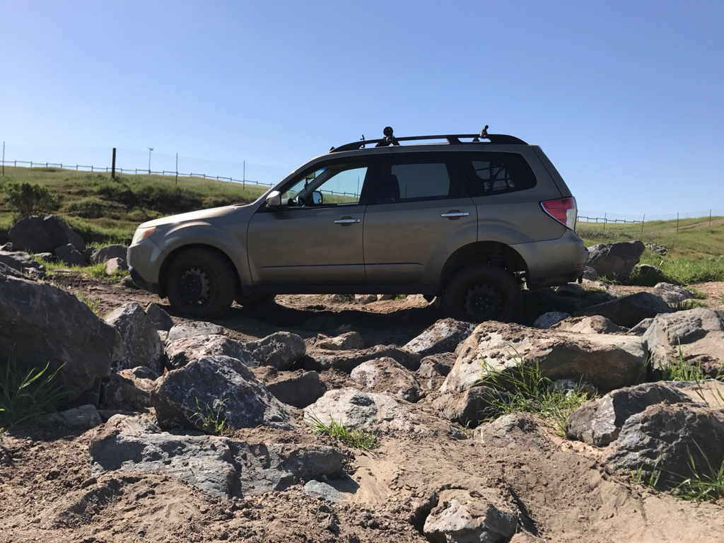

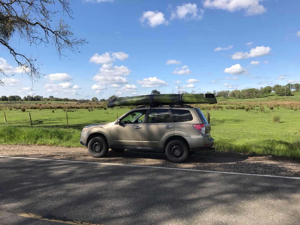

I miss my Forester. I installed a lift from ADF and I did things in that car I never thought a Subaru could do. Wife is looking at getting an Outback soon. Will probably install a lift on it too. Subaru’s are tanks! If you take care of your normal maintenance that car will run forever.

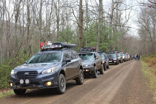

There is an 'offroad Subarus of wisconsin' group on FB. And a MN one. Also on Facebook is a Subarus offroad international page. Lots of good info there
I make it almost routine to recommend seeking out a local MtnRoo chapter to all new Subaru members. The planned events that happen are a great way to get off road and be comfortable learning how to handle your Subaru in all sorts of environments.
