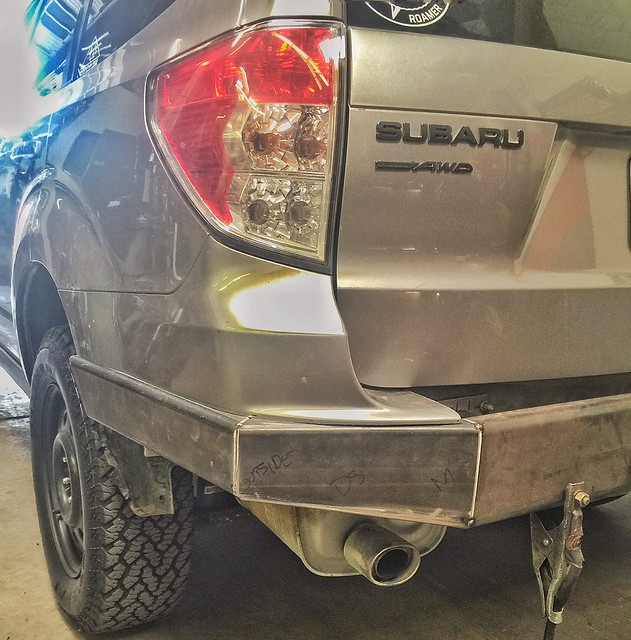

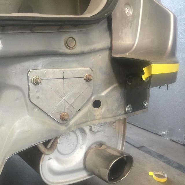

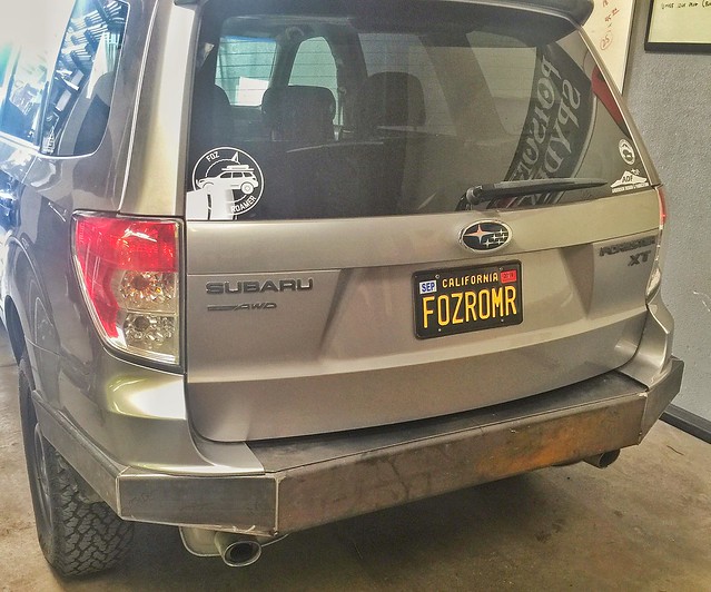

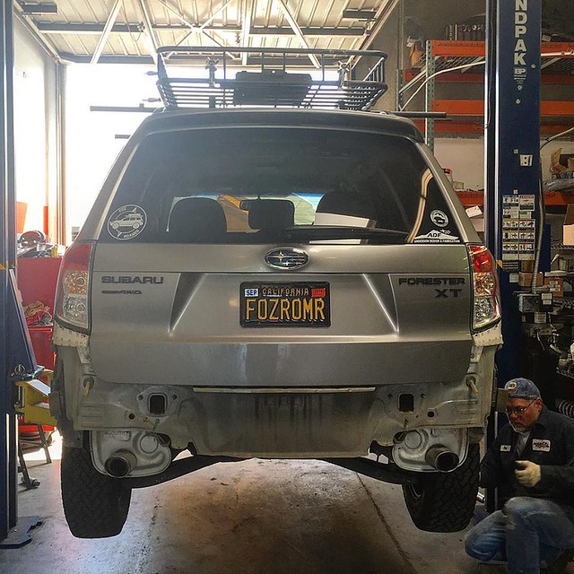

Since I am lazy and do not want to start an official build threa yet I thought I would start a thread for reference to a custom rear offroad bumper that I am getting built and designed by Leadfoot Offroad in Socal. Any questions just let me know. I am not aware of anyone in the US that has done a custom rear offroad bumper to this quality and features like this on this generation Foz. I am trailblazing a new path here and these guys plan on doing more Subarus in the future. These guys know their stuff and are a top notch fab shop. The build should be done in about another week or so. Should be totally completed by next week.
When completed features will include:
1. 3/16 steel construction (yes it supports the weight through added reinforcement..upgrading to stiffer king springs soon as well)
2. Hi jack lift compatible
3. Spare Tire mount
4. Dual D-Ring mounts
5. Dual jerry can holder
6. dual LED lights built into rear bumper with wiring harness
Pics so far

That's a nice looking bumper! Whats the weight of that thing and do you notice any difference when driving?
Thanks man. Its fully custom and I did tons of research before deciding to pull the trigger. This is just in the beginning stages and by next week it will come full circle. Ill post up pics when its done. I rarely go on here anymore really because so much other stuff I have going on, but I will try and remember.
