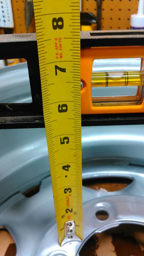

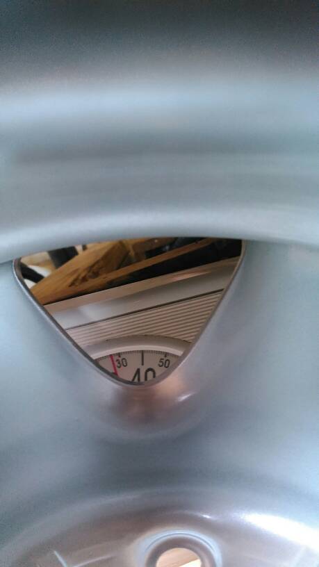

This is more information than review. I have looked for this information about my Tacoma steel wheels. I was only able to get it when I bought a used one for a spare. The OEM wheel weight is 28 pounds and the backspace is 5 1/4 inches. Hope this helps someone.

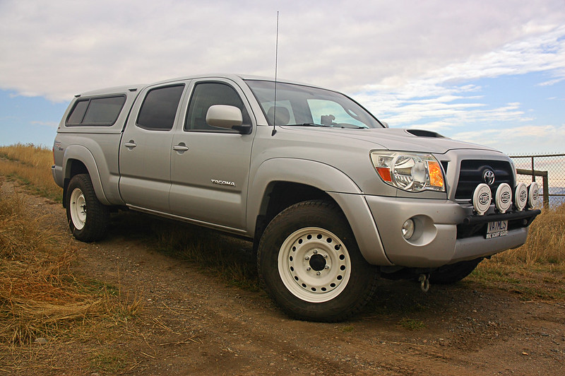

I run Fj Steelies in the winter;
17x7.5
+15mm offset
4.5" backspacing (vs stock Tacoma 5.5")
And then painted them white;
I love the look, they are rock solid, and at $90ea they were a better price than waiting for takeoffs to come along.
17x7.5
+15mm offset
What tire size are you running?????
vicali
1,113
255/70-R17 Blizzak DM-V1.
A little bit skinnier and taller than the summer stock 265/65-R17 size.
This spring I'm putting 265/70-R17 Ko2
Big E
3,384
Morganton, NC
3420
I debated that wheel with a 245 75 17. stock width and an inch taller. thanks for the info.
