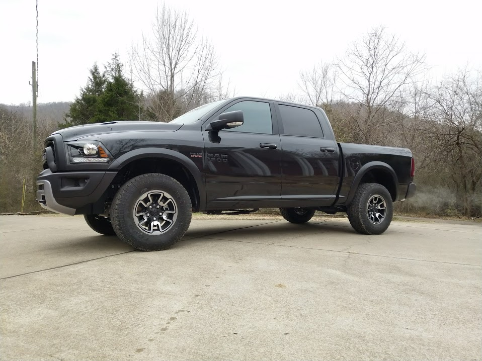

Got the level lift in and it's exactly where I want it.
Also mounted the batwing with some fabrication help from a buddy.
