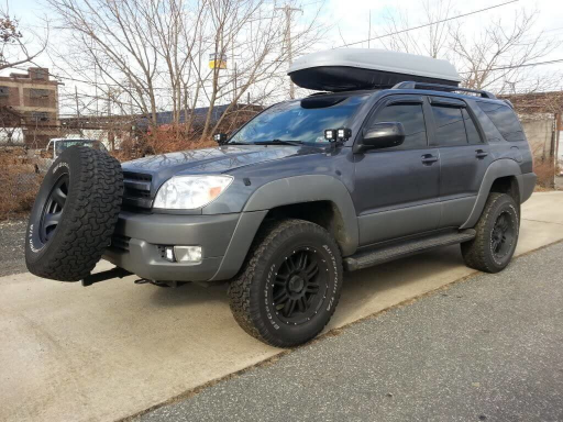

It will fit underneath as others have said… if not, there are hitch mounted spare tire carriers that work decently, or use the excuse to get an aftermarket bumper with carrier (aftermarket bumper is the route we went).

Rigd Hitch Mount Spare Tire Carrier. This has worked well for me for over 1.5 years. As others have mentioned a 33” tire may fit underneath. Mine did but I hate that location.

Yea, I can see how hard it would be to swap on the trail. How long did it take for you to receive your RIGd mount after you ordered it?
3-4 weeks, but since I ordered it a long time ago delivery times may have changed.

Cool, that looks like an option when traveling light. I think I'm leaning towards the rigd ultra-swing. It's only 60 pounds without all the accoutrements.
