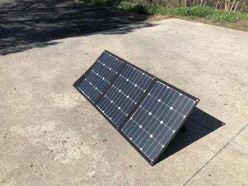

Ok, so I gave my 105W ACOPower panel (https://amzn.to/2rk1nhy) to my wife to use in her van conversion. She has a generator, so solar isn't as important for her as it is for me...
I in turn replaced it with the new 120W ACOPower portable panel (https://amzn.to/2rgRzF5) - essentially the same size and weight, but 15W more power...

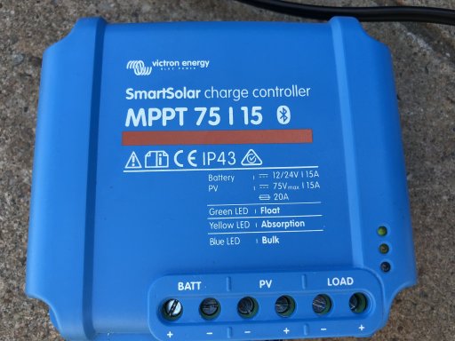

After lots of research, I replaced the supplied PWM controller with an MPPT controller (https://amzn.to/2IdvUqR). Since the one that came with the 120W panel is nicer than the one on the 105W, I am replacing hers with that one.

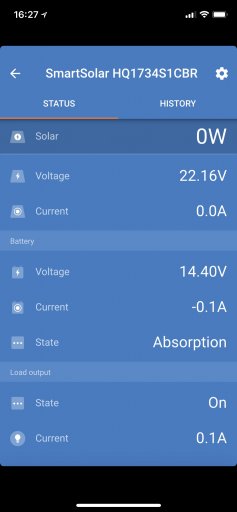

My new controller has BT built in, so it's nice to be able to monitor the panel using the free app.
1. The app screen (no load or battery attached...)
2. Close-up of the new controller. I opted for the 75V/15A version, since that will allow me to run two 120W panels in parallel, if I so choose.
3. The 120W panels. Pretty much identical to the 105W ones...
