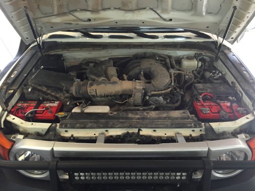

I have hard mounted a 100w solar panel to my roof rack. I have a duel battery set-up. The purpose of the duel battery is the auxillary battery runs all of my external power requirements: fridge, HAM, iPad, etc... The solar panel keeps the batteries topped off when I set up camp or am parked anywhere. By keeping all of my ancillary devices isolated from my primary battery, keeps it charged so I wont be stranded, theoretically that is. I like to travel by myself sometimes and this is a backup for me.
In the future I do plan to by a rechargeable jump kit to carry as a true backup.IMG_2943.JPG Phone download 6-8-16 736.JPG

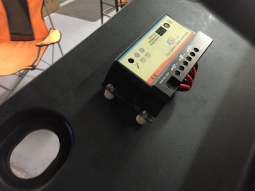

I have 2 75 watt solar panels that I use on our travel trailer. I keep them as a mobile unit, and generally will take 1 along with the Xterra when overlanding. I have solar controller mounted permanently in the travel trailer, and another mounted in the Xterra. I really only use the solar panel if we are staying put in one location for a whole day or longer, otherwise the travel keeps both batteries charged up perfectly fine.

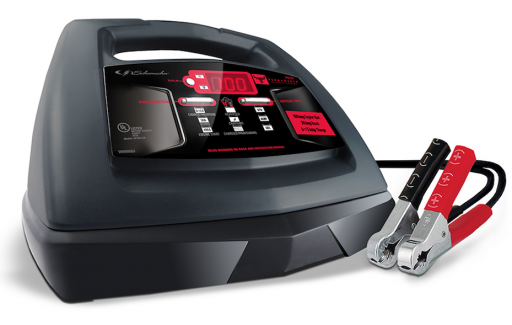

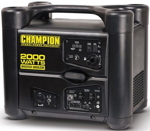

As sexy as solar is, I can't give up my 2kw Genny (8 hours on 1 gallon) and Schumacher FR01235. I get 12amps of battery charging power (day or night / rain or shine), equal to TWO 100w solar panels (approx 16 square feet), which only get their rated wattage about 4 hours a day, pointed directly at the sun, with no cloud cover. Plus, I get 100amp jump start anytime I need it.
5 Gallons of gas will give you the same charging power as two weeks, with a 100w solar panel, in perfect weather.
Total cost: $600
True: It's not as Eco-friendly, but if we were that "Green" we'd all be backpackers ;-)
Also consider: Running your batteries below 50% is hard on them. With this setup, you can avoid that, regardless of weather, latitude, time of year, or time of day.
ONE FINAL NOTE: Whenever possible, I try to only purchase things that serve more than one purpose. Example: If your power goes out at home, this generator can keep all the food in your fridge/freezer from spoiling. Food for thought ;-)
