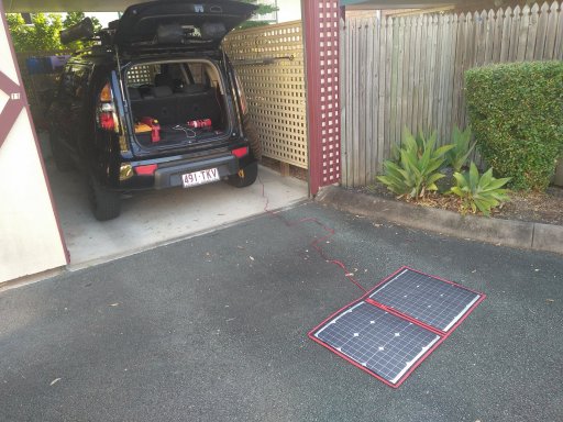

Awesome !....I recently installed a solar controller (20 amp)...and am awaiting the panel i ordered (80 watt)....it's to maintain my Aux. 40 amp Gel/ Deep cycle battery...

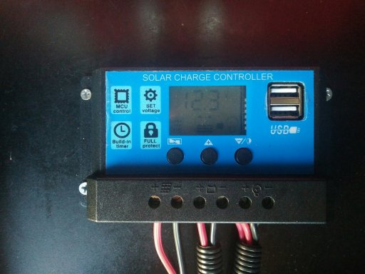

What solar controller are you using if you don't mind me asking? Also...are you folks mounting the controller closer to the battery or the panels? Or does it matter as long as you get the right gauge wire? I noticed the ACO has 14ga while the Renogy has 12ga wire which is better for line loss on long runs
Looks like it's this one... http://amzn.to/2BFqO0Z - Google Photo search to the rescue :)

That's the controller...(above pic....thank you @Wotan ) I sourced it from Ebay however....the cable, i cannot recall the gauge but sturdy enough and is only about 50 cms long, as the battery is just below the shelf mounted on a tray direct to the floor...will do a little video when the panel arrives...cheers for now !
