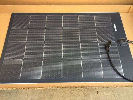

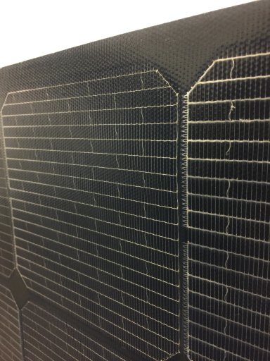

I was able to visit Merlin Solar here in San Jose a while back. They make military and semi truck fleet solar panels. Flexible, rigid and portable panels. The COO was telling me they have been busy supplying much of Puerto Rico with residential solar after all the hurricane destruction. Check their website out. They are tested for hurricanes and also obviously military tested. I was very impressed with their operation. Wish I could have taken pictures, but all the solar panels are actually made at the facility in San Jose, California! Blew my mind. They are pricey, but very well made and steps ahead of most everything else. Check out the cell grid. 1000+ points of contact mean they are literally bulletproof and won’t fail. I took home a small 110 watt for my truck and have had great results. They can make any size panel. Residential And Commercial Solar Roofing | Residential Solar PanelsF3CBD6A0-7F27-4838-A801-6B7645D29A63.jpegD5196684-B626-4EFE-8B42-C10AB714A0B6.jpeg9445C19B-6408-4E35-85B5-41C0B6079B6E.jpeg515481DF-607E-48F6-B182-713BF7729176.jpeg

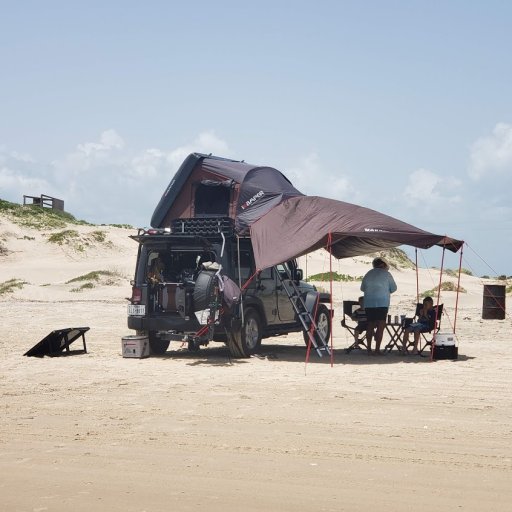

I been off grid camping for about 6 months off and on. I got the Yeti Ground Zero 400 non lithium solar generator with the 100 watt Yeti boulder solar panels. Went with the non lithium version so I can charge off the car 12 volt system while driving. (If you have an AC outlet in your vehicle you can use it to charge your lithium unit) What I power up is a 50qt Dometic Refrig/Freezer, recharge batteries and a sleep apnea machine. If I do not get full sun after a full night use my battery will be drained by the end of the day. I plan on adding a second battery to see if that will get me a full 24 hours. You may want to consider a larger solar generator. The 400 is great if the sun is shinning but I had a three day trip that there was no sun and l was lucking I had some frozen water bottles at the bottom of the refrig and that kept it cold until we resumed our travel.

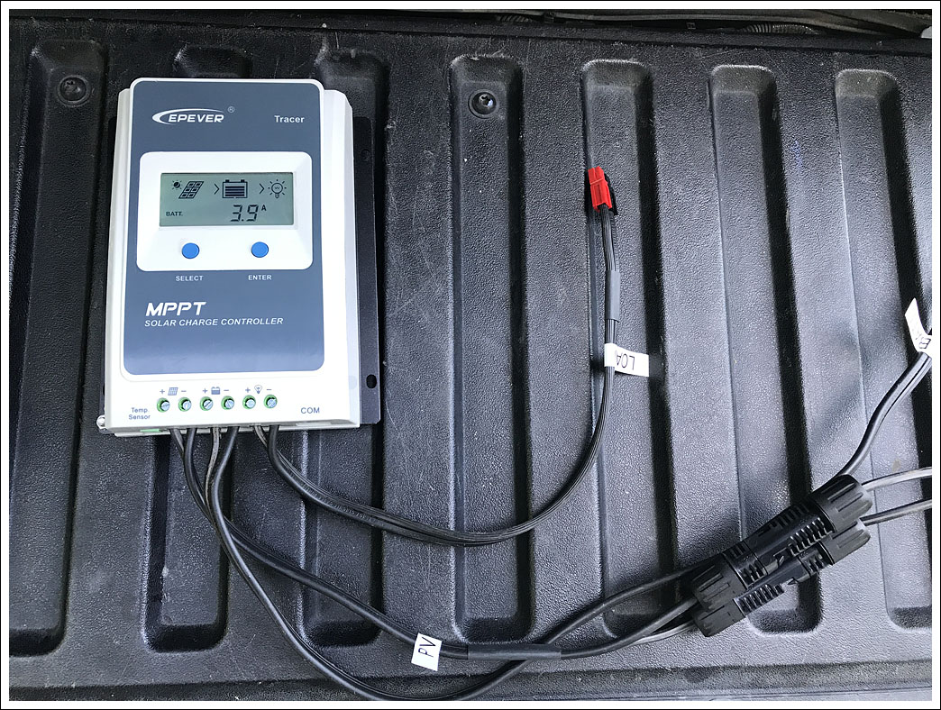

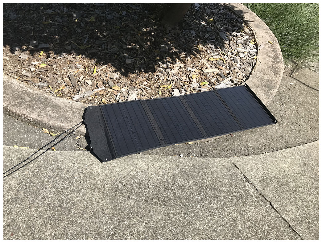

I've been looking at solar panels for a while and after some consideration decided that a portable setup would be better for my use than a fixed mount panel. There are multiple portable options out there at various price points. My goals were to keep things as small and light as possible, while staying with a high quality monocrystalline silicon cell. Ultimately I went with the Rockpals 100W Foldable Solar Panel which uses Sunpower cells and various output options including a built in USB charger. To me the main benefit of this panel are the build quality and the fact that it has 4 panels so it folds down into a smaller package than the 2 and 3 panel options.
The panel can plug directly into my Flexopower Lithium444 power pack which has a built in MPPT charger. I also purchased a separate EPEVER 10a MPPT charge controller that I use to charge my truck battery in camp. The portable panel allows me to park the truck in the shade and put the panel in the sun, and then keep my battery charged while the fridge runs. At home I can charge the power pack and use it as a power source if the house electricity is out. I built an extension cable for the solar panel out of 12awg landscape wire and MC4 connectors. The connections to the fridge and battery are 30A Powerpoles.

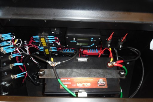

Renogy on my square drop trailer, 100w monocrystalline portable suit case panel, 15ft of 10 awg cable, Renogy Adventurer 30amp Charge Controller w\ battery temperature scensor & 125ah VMax AGM battery. Personally I prefer monocrystalline solar panels have the highest efficiency, these solar panels yield the highest power outputs, they also require the least amount of space, they perform better in low levels of sunlight, making them ideal for cloudy to overcast conditions. With the 30 amp charge controller you can add up from 100w panel to 400w of panels 4 100w.
