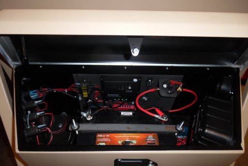

I've done 2 builds both have solar both I used VMax Tanks 125ah SLR Series AGM battery. I never had an issue with this battery, IMO this battery supersedes any battery, withstand repeated cycles yet stay charged with minimum self discharge in standby power back up modes. Can withstand extreme cold weather conditions w\o losing charge. 1st photo was my 1st build for my RRT trailer, 2nd was the current build I finished square drop trailer.
very nice. I wish my power management looked that clean, lol. I'm working on getting it organized, but not gonna have the resources to redo my entire system right now. It's on the priority list though. Probably when I upgrade the solar and batteries, that would be the ideal time to rewire everything. Thanks for the info on the batteries, I'll have to check them out
View attachment 103030View attachment 103032
Love the clean install!
