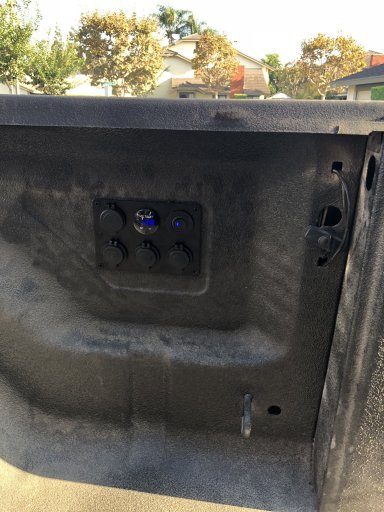

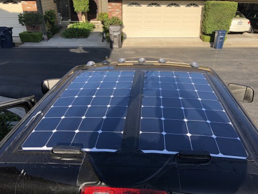

I have 2016 ram 2500 as well and have recently installed the setup you’re talking about. I’m running 2 100w panels taped to my roof with “RV tape”. Ran the lines down my 3rd brake lights and into the back seat. There I have a Renogy 40 a mppt. They also make one with a dc to dc charger (which I should’ve got) the dc to dc charges your batteries through your alternator while driving. Then I’m running the lines into the bed of my truck to 2 vmax 125 batteries. What you see in the pic are 2 optima blue tops. I bought those originally but realized later that they were only 55 amp hours each. With the new vmax I get 250 amp hours now. I haven’t run the system with the new batteries yet but with the optimas I was able to run my dometic CFX 95 and lights for 2 days without any problems. With the renogy app you are able to see the amount of energy coming in and going out. I noticed that the energy coming in was only greater by a small margin over the 2 days I used them. That’s why I upgraded my batteries. I may be getting a separate dc to dc charger now as well although I don’t think I’ll be needed it.
I hope this helps!

Very cool! I like how that RV tape is holding the flex panels. Do you have a cover for your bed?
