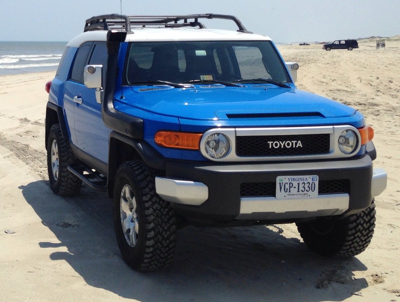

Snorkel for sure. It gives you cold, clean air, and provides some additional safety if you find yourself going in a little deeper than you'd planned. We bought our snorkel before we'd even bought our FJ. http://amzn.to/2uW8jp6 looks identical to what we got. Don't waste your money on the ARB stuff. It's a plastic tube, there's no magic that comes from paying $200 more.

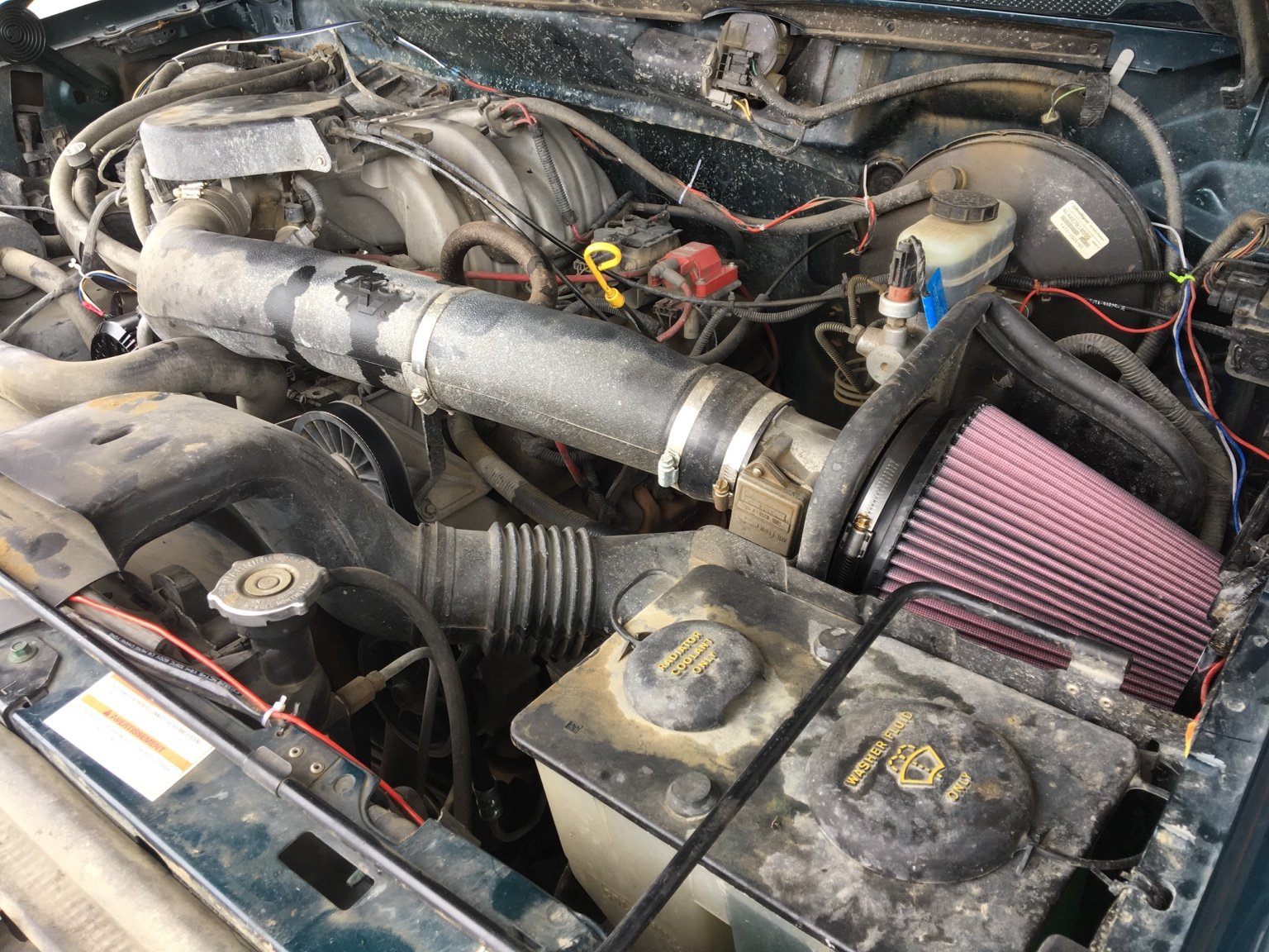

Or combine the two. I am currently running a K&N cold air intake on my 94 F150 and am in the process of building a custom snorkel for it that should have a nice clean look. Going to replace everything after my MAF and install a spectre inline air box and fab up some piping. Got a build thread going on my truck for anyone interested. IMG_8863.JPGIMG_0946.JPGIMG_0993.JPGIMG_0991.JPGIMG_0992.JPGIMG_0990.JPGView attachment 67627
