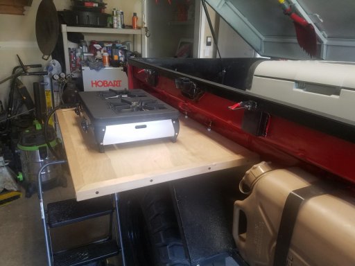

My Bantam is 4’x6’, and We have no trouble pulling it anywhere. It has a RTT, and can holders. My kitchen is just a plywood shelf hung ove a fender though. There is a Dometic Cfx65dz inside the trailer, but getting into it while the tent is deployed is a bit of a pain.
