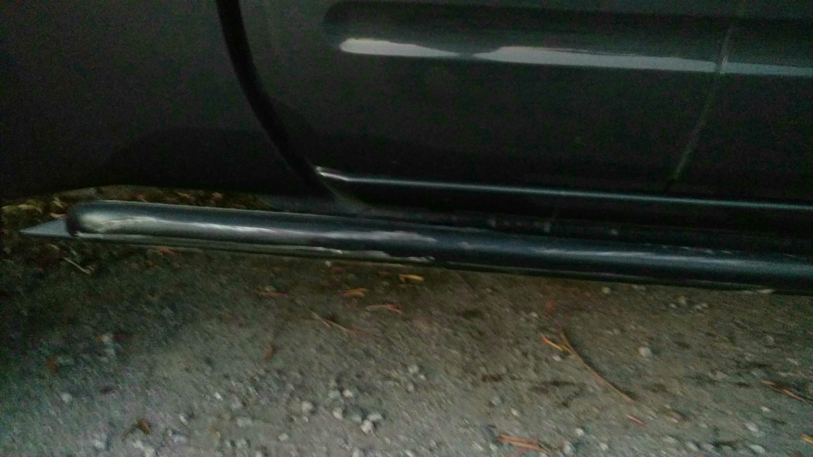

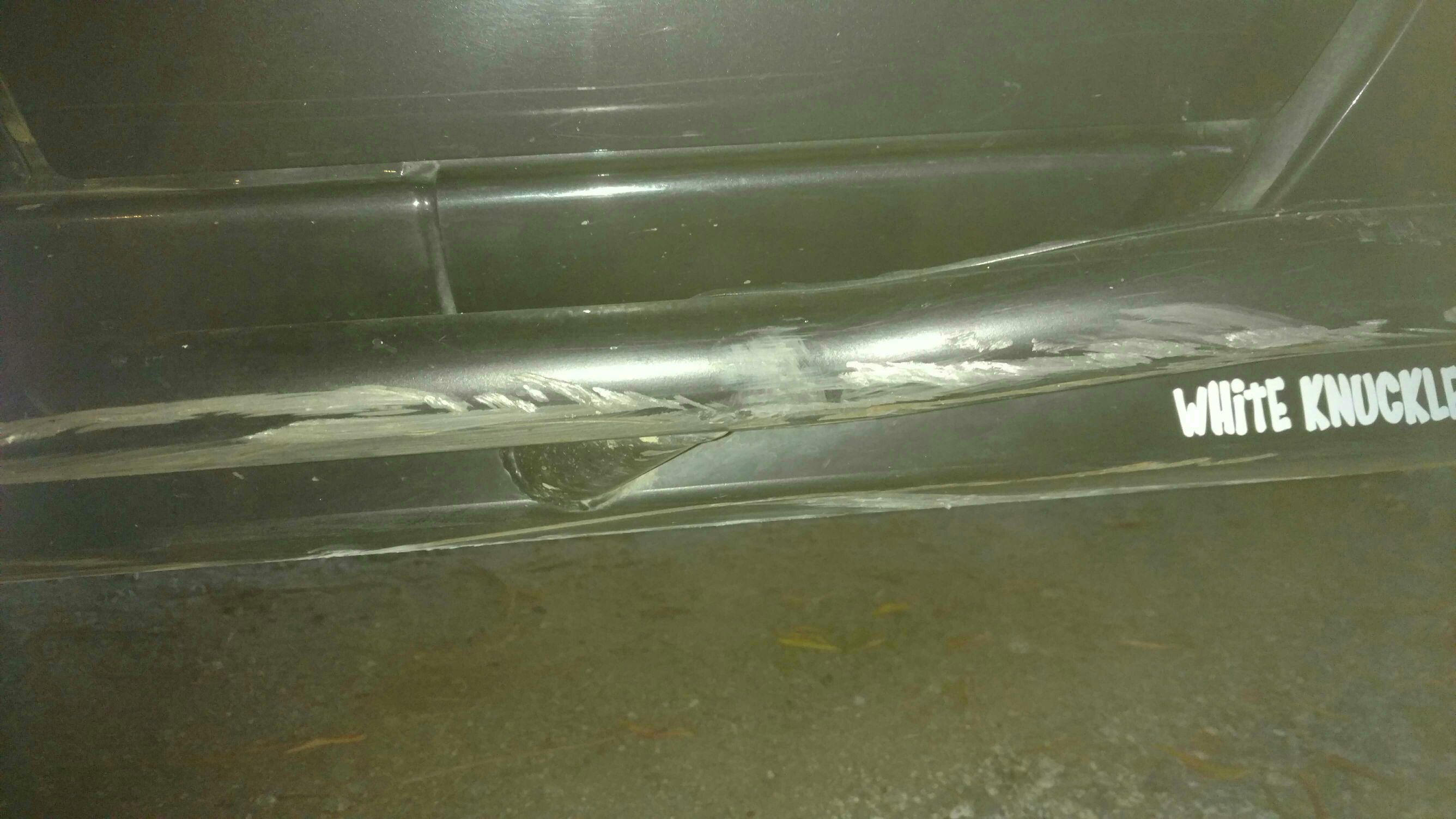

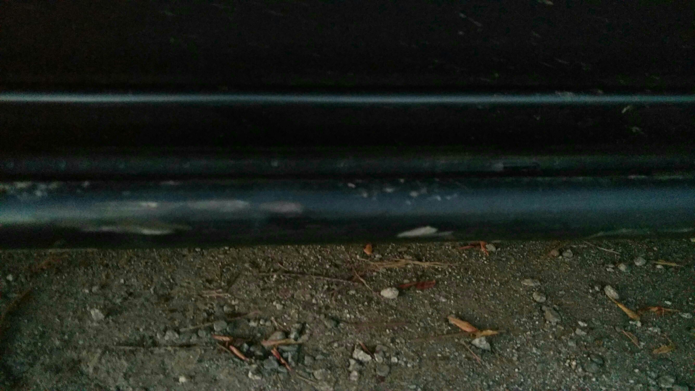

Thats what my sliders and skid plates look like the Rubicon made sure I knocked the mall crawler right off.
Hard for me to tell from your photos, how are your white knuckles holding up? Just cosmetic? I just ordered a set from them in 0.188 DOM for my 7,500lb truck.

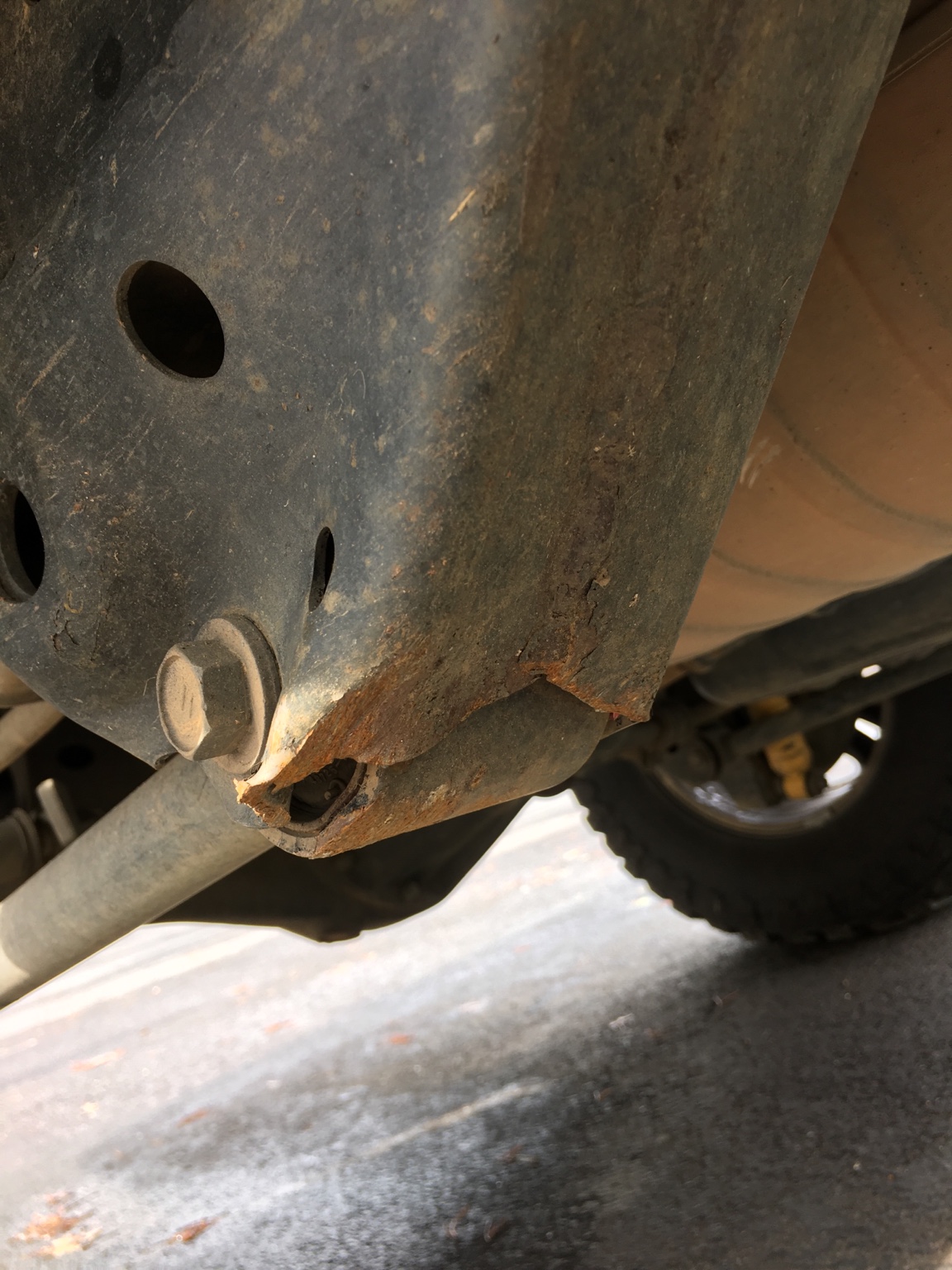

IMG_0001.JPG I don't know how common this is in aftermarket, but I think the way Dodge designed the skids for the power wagon to be light weight is pretty genius, and seems easy enough to replicate DIY.

View attachment 10214 I don't know how common this is in aftermarket, but I think the way Dodge designed the skids for the power wagon to be light weight is pretty genius, and seems easy enough to replicate DIY.
Thin gauge steel, about the same as my OEM's (which I haven't yet replaced)
Offers good skid protection, naught against crush/puncture.
If you got hung on a rock the weight of the rig would demolish those. Full steel skids usually offer minor load bearing properties so you can safely drag yourself across.
Realistically, skids are for rocks. If you're not doing serious crawls, OEM works fine
White Knuckle makes bomb sliders. I joked today that I need to Bondo them before I paint the rock rash 'cause the gouges are so deep. They rash, but they ain't bent yet. They hold the full weight of the truck just fine. Watch that clip.
