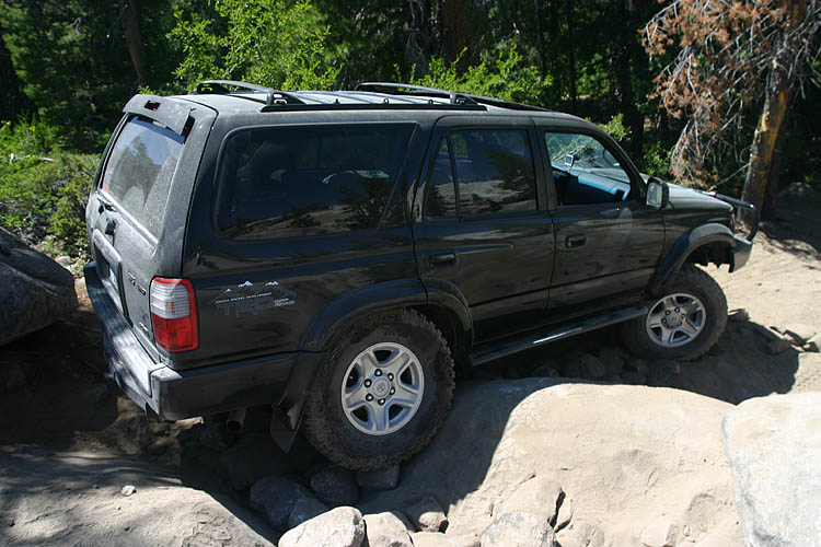

This has happened twice now, it's a super noob move, but I think that taller bumpstops would be the fix (that and choosing a better line).
The video shows the mistake.
BACKGROUND: I have a Gen 4 rear end in my Gen 3 4Runner. It's wider than the original. The rear is lifted about 3" with OME springs and Bilstein 5100s. I think the extra width and the lift are allowing the tire to ride up too high when I'm going through this kinda obstacle, if there was a taller bumpstop it would prevent it.. RIGHT?!
thanks.

A taller bumpstop would limit your up travel, and help keep the tire out of the fender. That said, ideally your tire would be able to "stuff" into the fender but with your wider rear axle that may not be possible.

I'm surprised the front wheels weren't able to pull the truck forward a little bit, it doesn't look steep.
It's possible that the front drivers tire was unweighted and spinning as well. That could happen if the truck was balanced between the front passenger and rear driver tires.

Bit of a bad bad line too maybe would you have been better off more to the right, looks like you could have kept that wheel on the ground.

A rear locker should have gotten you through that in 2WD. 4WD should have pulled you through that even with open front/rear. Do you not have a rear locker and/or not have 4WD? As for the clearance, it actually tucks the tire pretty darn close to perfectly. I'd roll those fender lips and then you'll be good to go there. Add a rear locker, and you're golden.
-TJ
With the Gen4 rear end, it isn't an option that I have been able to find.

Your center locker should have gotten you through I would have thought. I have the same setup on my Discovery, CDL and open on both ends. Do you have any form of traction control ?

time to get a body hammer and fold the flange on the wheel well
does your TC have a 4locked plus a 4open dif?
cuz if the TC was locked both front tires should have pulled you thru
if the TC was locked, the left front tire should have been slipping too if you could not move.
