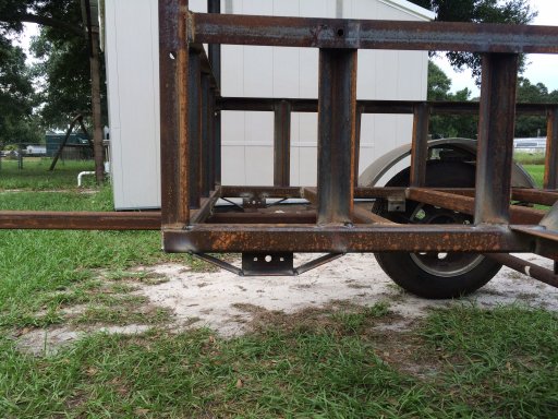

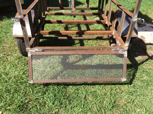

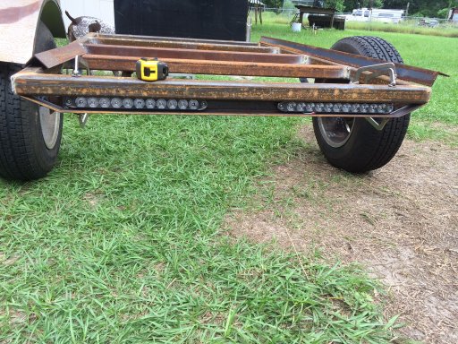

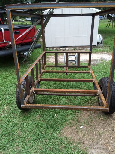

So I had this trailer build floating around in my head for a couple of months with not a lot of spare time to build Went to work one morning only to find myself with more time than I knew what to do with so after finding a somewhat steady source of income it was time to build a trailer I was hoping to build and sell but not much interest in my area plus there’s the liability side The trailer is 2x2 by 3/16 frame side rails and tent support are 2x2 by1/8 angle Size is 4x6 and 4 foot from deck to tent support 5709B5FA-6618-4F20-9DFB-E76344ACAF25.jpegCD543A79-409F-4119-B8CF-E26EE6CBAE64.jpeg5709B5FA-6618-4F20-9DFB-E76344ACAF25.jpegCD543A79-409F-4119-B8CF-E26EE6CBAE64.jpeg5709B5FA-6618-4F20-9DFB-E76344ACAF25.jpegCD543A79-409F-4119-B8CF-E26EE6CBAE64.jpeg1C5B2993-1ABB-4738-850B-B1AB7D330C58.jpeg214710DB-F588-4C1F-B73D-9537ACC1563C.jpeg78867CCF-BA3F-4807-9B0F-904952E37737.jpeg706CF7BC-45D9-4995-8371-75E1B8018042.jpeg7C71D626-5227-459E-A8BC-1F1955CF7AAC.jpegDEB6E58A-55B2-4D18-AEE4-DF42887CAD78.jpegACBDDDD3-A637-40BB-B97B-E4AA6A3318F7.jpeg63E1A895-895E-4255-8DDB-C8B46E094432.jpeg01C7129D-37AD-46F6-A428-45475D529D2D.jpeg93784EED-9CA4-49BB-97FF-E8AD926ADCA4.jpeg0EDF1E52-99BE-4A1B-9B98-7BA75AB152AD.jpegBD99D90D-D62E-49CA-8BEF-C90BFD7CF1A3.jpegA341AB12-FADC-45C0-B298-EAFF7AC6B99D.jpeg1790A122-9664-4DE6-ABA5-FAF3D4E46E00.jpeg1B07D3FF-04E0-4368-86C9-6046A5BA068B.jpegA3F6BC34-679B-4565-AA23-C1C979959ED3.jpeg736BF5AD-C14E-432C-AE33-A1AA2558D921.jpegD17FB5AE-45FF-4B44-91C4-CD58E14F62C5.jpegC525E709-B872-45A3-8658-F7B71560CBA0.jpegF10DEEA0-08A3-445E-AD9F-AE1027D01CE0.jpegB04DFD4F-79A3-44E4-AEF2-DC92242D27E0.jpeg3C255E63-0489-4C06-9DBD-EF367F1C8F15.jpeg5429CE20-8E8D-42F1-96D2-84B3FB7AEAE9.jpeg5A5A363B-EB2F-452D-80BA-CFD1E7E68027.jpegall lights are led recessed and protected by 2x2by 1/8 angle gate is latched by quarter turn spring locks trailer with smittybuilt tent and awing weighs 800# just open design to hold pelican cases or kayaks as pictured

Hey thanks for your the comment on the hitch lift it is a 2500 lb warn winch mount under the bed to the bumper with a wireless controller it is about ten foot as seen but it will collapse that fit in the bed l keep the lift limit around 400 to 500 pounds and with airlift bags on the truck it doesn’t sag much at all
