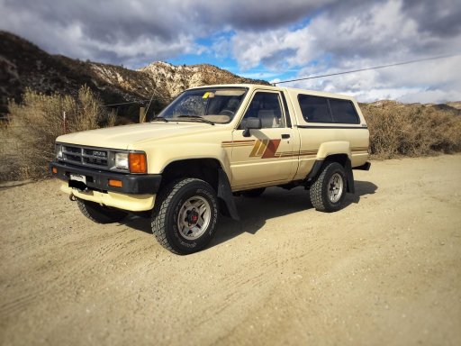

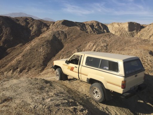

Hey yall,
Starting this thread to show the progress ill be making to my 1987 4x4 Toyota pickup. Being a college student with a limited budget and a 30 year old truck I plan on proving that you don't need the newest and most expensive vehicles or accessories for overlanding, just the passion! Most parts will be bought used off craigslist/ used part websites and most fabrication will be done by me, I'm a certified and truly enjoy the craftsmanship part of metal fabrication. The build will be slow but ill try my best to keep it interesting for yall!
Here some info on Sheela:
1987 Toyota pickup 4x4 single cab
22r engine with 183xxx miles
manual trans
manual steering (soon to swap to power, manual steering is a bitch in San Francisco!)

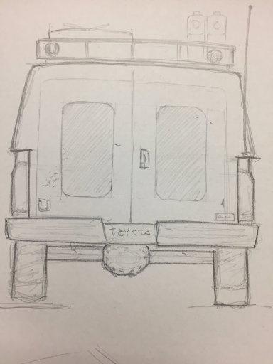

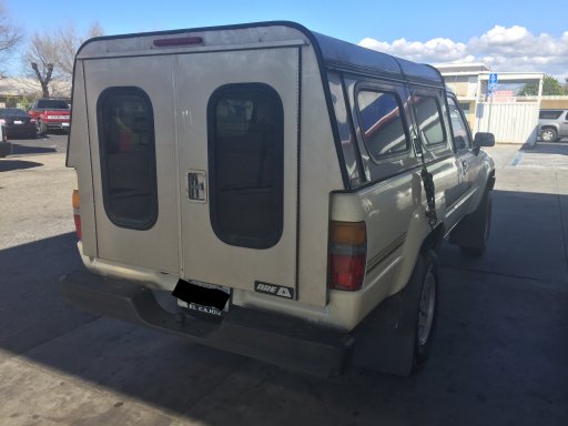

Alright guys,

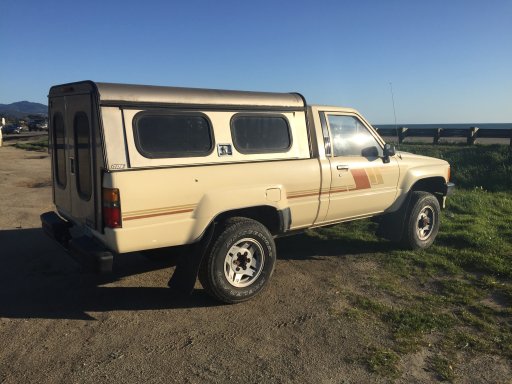

Came up with an easy sturdy camper idea, and lucky enough I picked up an ARE utility camper shell for only $200 on craigslist. It's for a ford ranger so I'll have to do alittle chopping on the barn doors to fit but no big deal. With the aluminum frame I can safely mount a roof rack with tools/ tent. For the short term I plan on camping on the inside and having toolboxes/ storage on the roof. Check it out!

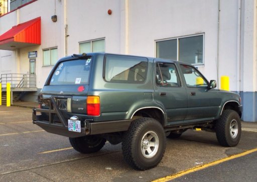

Some people are against them but ive had great luck with putting a 2" body lift and then www.4crawler.com 2" motor mount spacer , that will allow you to move the trans and t case up and almost get a completely flat belly skid all the way down. .

I was able to drag this thing over a lot of stuff thanks to the flat belly pan, the t case hangs down way to far from the factory I never understood why Toyota did it that way . Like I said it's not for everybody but I doesn't want to crank up the torsion bars because all that does is puts the cvs at a steeper angle and makes it ride horrible C5F71D9A-EF92-49EE-B3FB-4FAB0AEE3C4E.jpg

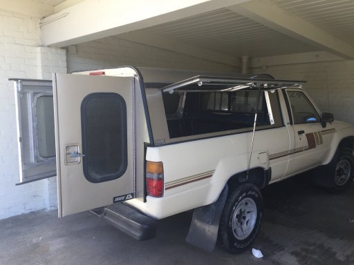

Got the camper all trimmed up and mounted! Color is alittle off but that's kinda the point of this truck, it's not perfect! Tommorow I'm going to look at an offroad tube bumper with a winch mount, it may look funny with the stock tire size but that will soon change
