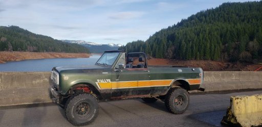

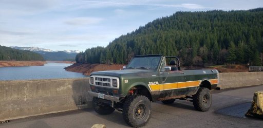

Hi all, new member here. Im new to overlanding, fairly familiar with "wheeling" I'm excited to get into this because it's something my wife and I can both be apart of.
The rig is a 1980 IH scout II. I swapped in a 7 3 Idi NA.
It has so much torque at low rpm I am excited its in the rig.
It has a factory t-19/ dana 300 TC.
Dana 44 front and rear with a rebuilt powr-lok limited slip in the rear and open front. Axles rebuilt, transfer case rebuilt, engine was resealed and painted. New IP and injectors. I have minor things to do to finish the swap but it is now driving.
I'm looking to add a winch bumper in the front with skid plates, beef up the axles. I'm starting this thread to get ideas from other people who overland in "old iron" sometimes I would love something newer but Its always fun doing it retro. 20200119_152457.jpg20200119_152448.jpg
I'm looking to add a winch bumper in the front with skid plates, beef up the axles. I'm starting this thread to get ideas from other people who overland in "old iron" sometimes I would love something newer but Its always fun doing it retro. View attachment 136075View attachment 136077
