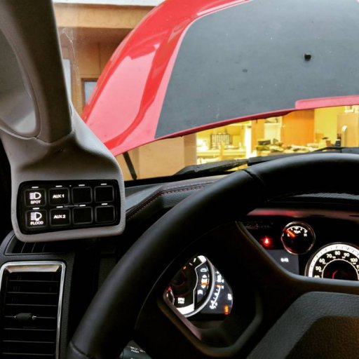

I went with the switch pro 9100. I absolutely love the thing. The blue tooth makes changing settings very easy. I originally had it on our 2016 ram 1500 and loved the set up and location for the mount i made. I have yet to transfer it to the new rig but will be doing so in the near future. The part that I really like about it and similar to the spod is that it makes the addition of new items very easy and you are only really wiring one with and a ground. As stated so you need it no, but it is very nice to have and imo makes the install of that many switched and relays extremely clean. IMG_20180924_184952_748.jpeg
