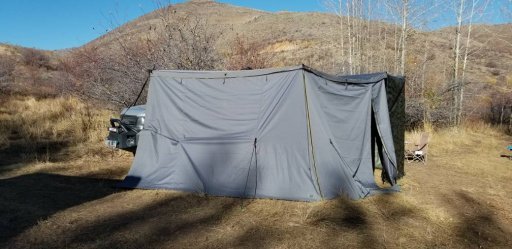

I am using a 270 right now as a very large tent. It is in the teens to 20 degrees outside and maybe 55 degrees inside it. We had a fireplace going inside tonight. Even with the back section closed off right now there us enough room to seat 10 or 12 people. To give you some perspective this is mounted to a Tahoe. Weather wise it can certainly keep you dry inside. With the walls in place it us very dry. Even my home made walls are working this weekend. The only thing missing is a floor but for my use I don't care. And we have much bigger scorpions in Nevada. But scorpions are not deadly anyway. I grew up in south Florida so I know your bugs and an awning will not keep them out but neither does a regular tent. Well unless you get in it before the bugs come out... lol 20191011_154530.jpeg20191011_185323.jpeg20191011_174429.jpeg

I am using a 270 right now as a very large tent. It is in the teens to 20 degrees outside and maybe 55 degrees inside it. We had a fireplace going inside tonight. Even with the back section closed off right now there us enough room to seat 10 or 12 people. To give you some perspective this is mounted to a Tahoe. Weather wise it can certainly keep you dry inside. With the walls in place it us very dry. Even my home made walls are working this weekend. The only thing missing is a floor but for my use I don't care. And we have much bigger scorpions in Nevada. But scorpions are not deadly anyway. I grew up in south Florida so I know your bugs and an awning will not keep them out but neither does a regular tent. Well unless you get in it before the bugs come out... lol View attachment 121705View attachment 121706View attachment 121707
This is exactly what I am looking to do. I sleep in a hammock which has it's own bug net, so I only need an awning for rain protection.

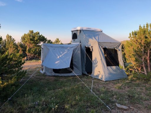

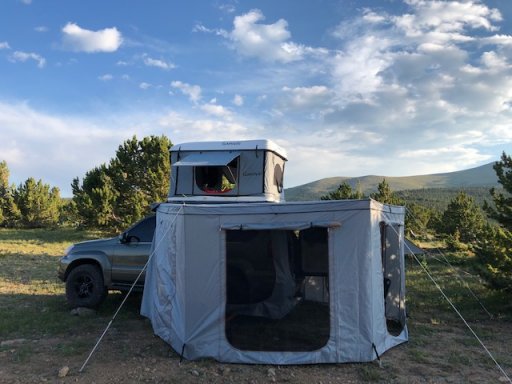

View attachment 123291View attachment 123292View attachment 123293View attachment 123294View attachment 123295
Nakman, I'm feeling like a real noob, but I've never seen the panels against the vehicle like that. What brand are you running?
These are Gamiviti brand, which is me. You can see more pictures on the site here: Awnings — Gamiviti Very similar materials to the ARB stuff, which I've run in the past also... I brought these in along with a few tents mainly to have on the trucks for branding purposes, but the awnings have kinda stuck as they work pretty good for the price point, and mate well with the racks, etc. I also sell the Rhino awnings and they are definitely better but also cost more. Rhino doesn't have a side wall though, just the angled shade thing for one of the panels... I don't know of any other full wall systems for a 270 degree.
