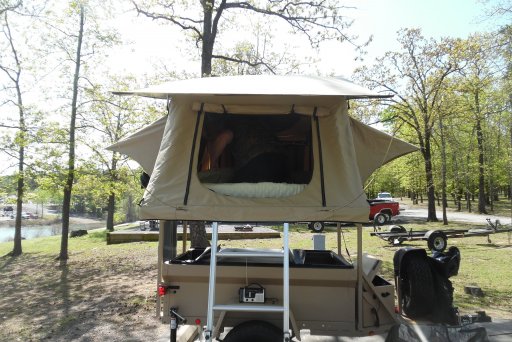

as a owner of the Exped Duo 10 Queen Size xl xw, I tossed my original RTT mattress. In my RTT is CVT Anti Condensation Mat & the Exped Queen size mattress only. Inflated it is 4" thick, the mattress IMO doesn't need any other topper or padding on it since it is adjustable for your comfort level after self inflation & the pump to make the slight adjustments of the comfort level your seeking.
Photo shown is my wife making the bed, you can notice how thick the Exped Duo Queen xl xw self inflating mattress is.
