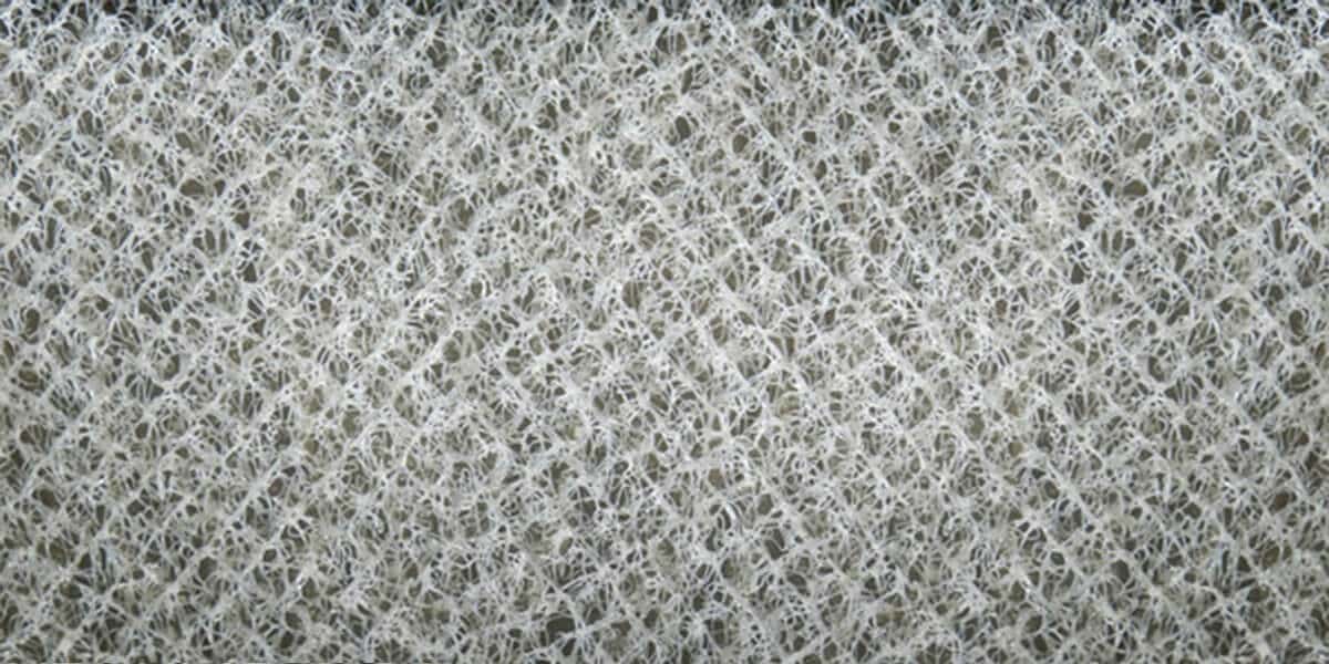

What's everyone using for condensation pads under the mattress in your RTT's? The only thing I can find on an Amazon search was the pads from Tepui @ $140ea, and I would need 2 is appears. There has to be a better option.

Try looking at this...
bshinn
646
China Grove, NC, USA
16593
Thanks, exactly what I was looking for.
