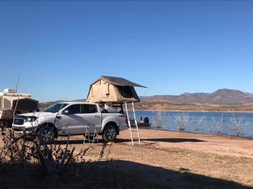

Has anyone used a Zero Breeze to cool their RTT?
Got caught in Boulder City area on the shore of Lake Mead blowing hot air , it read 115
Ended up having to sleep in the Ranger with air on, strong 115 wind made impossible for us.
I live in AZ, so there are so many amazing places to explore, but heat is a real issue for us , we are not spring chicks anymore.
