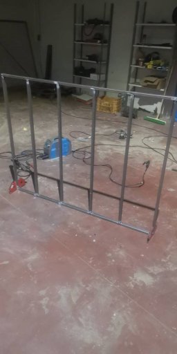

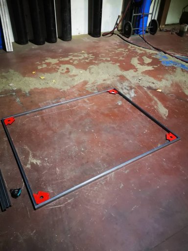

Hi guys, today i start a new proyect in the nissan terrano. We start with a 20mm x 30mm square tube, my roof rack has 160cm x 124cm. Cut 6 pieces at 120cm and 2 pieces at 160. Then weld everything and this is for now the result.
I finish with a couple of beers, tomorrow more!!!! [emoji609] [emoji100] IMG_20191113_180102.jpegIMG-20191113-WA0019.jpeg

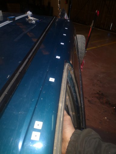

Well, let's get back to work. I had a pending issue with the roof rack and with you.
We are going to post some photos of the process. They are not all since editing the video for YouTube I lost many images.
We were inclined to use the rhino rack brand system since the rest of the European manufacturers only provided us with a system that did not convince us.
example:
We drill the ceiling to rivet the rhinorack tracks and apply the silicone.
IMG_20191123_170731.jpghttproofracks.sondermarketing.com.aupubmediacatalogproductrtrtv-track-00_lrg_3.jpg
This would be the result in the absence of making the legs to the roof rack
we have rejected the idea of using the legs provided by the brand as they are very tall. we are looking for a slim style.
