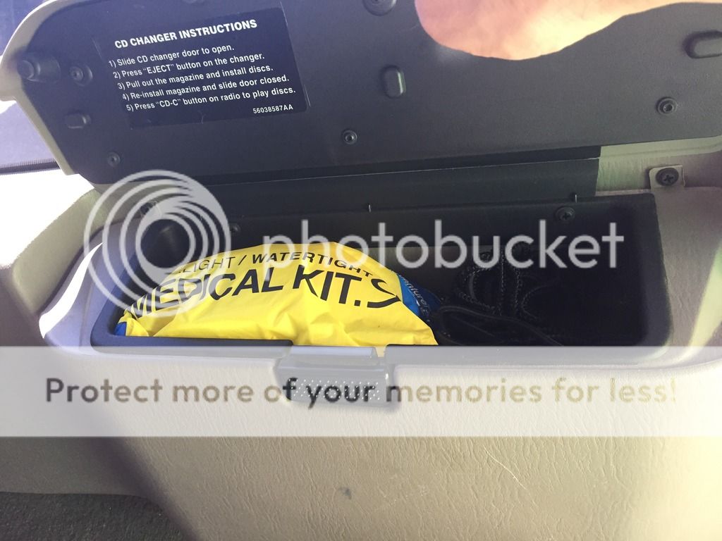

First I removed the stock CD changer and turned the empty space into a storage compartment for my first aid kit and roadside emergency kit.

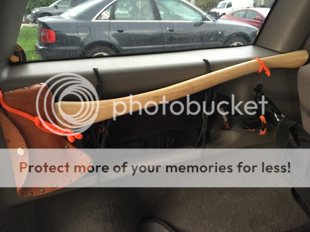

Next I drilled some holes in the plastic on the opposite side of the cargo area and a few in the sheet metal behind it, then using gear ties I secured my axe, machete and knife. I spend a lot of time in the mountains and use these tools are a regular basis, especially for clearing trail on search and rescue missions. I volunteer with my local sheriffs department.

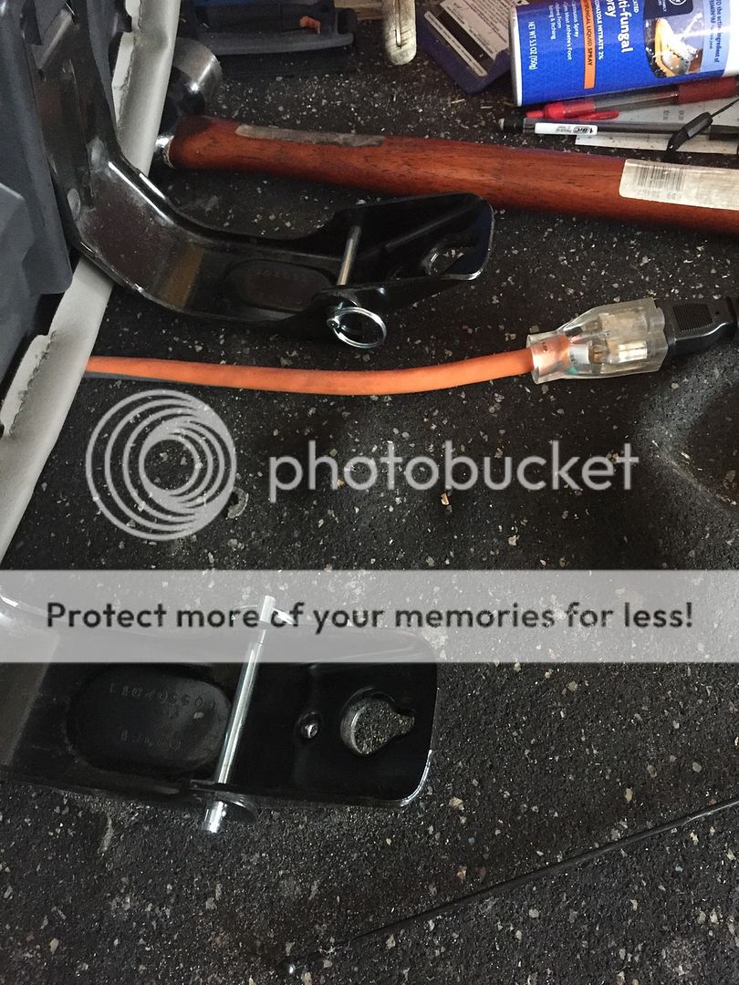

Next up was working on the sleeping area. I my Xterra the only way to get a long enough area to sleep was to remove the lower cushions from the rear seats one the rear seats were folded flat. Nissan made this easy with a couple of quick release handle you could flip and the cushions popped right off. Jeep just fixed them in place with solid 1/4" pins. I cut the pins and replaced them with 1/4" by 3" long quick release pins from Home Depot. Quick and easy. Below is the seat cushion on my work bench with the new pins installed.

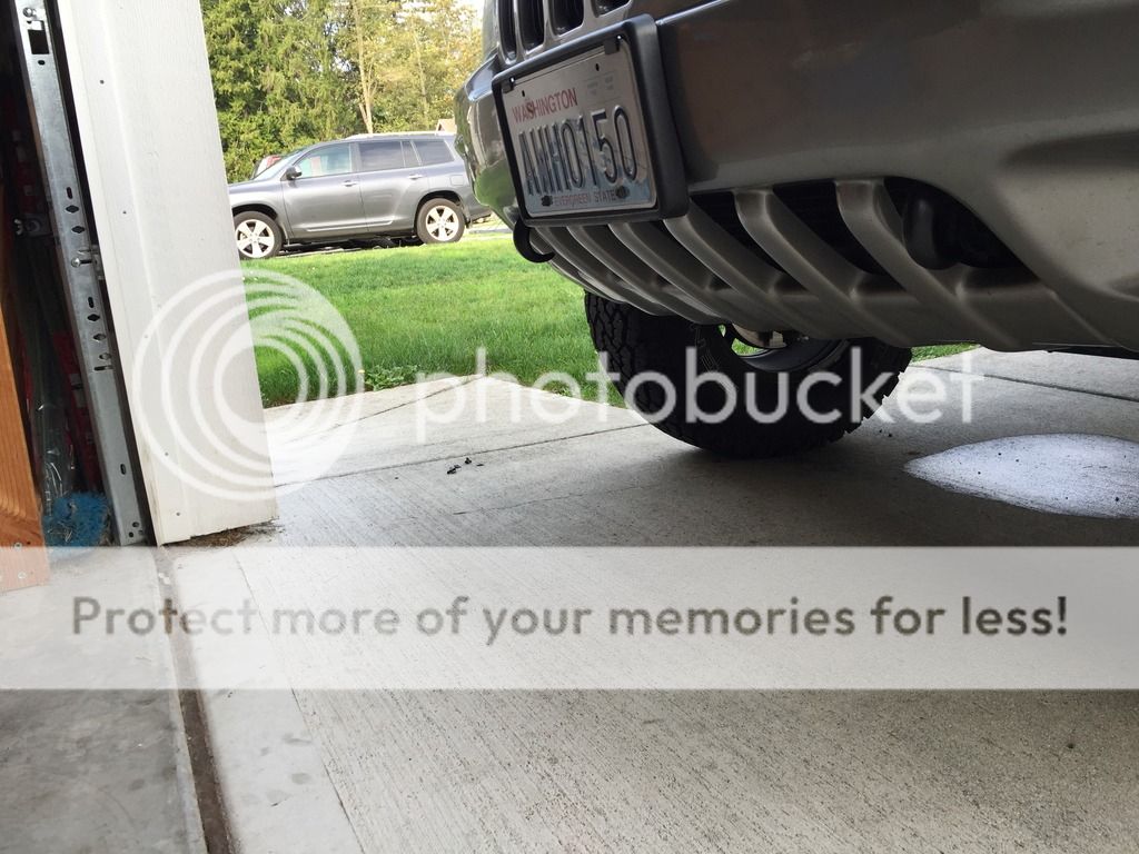

Once I had the wheel spacers on it was time to check for tire clearance, which yielded the need to trim the front bumper. Out came the angle grinder and a cut off wheel. I made a 2" cut along the bottom and angled it in going up the side leaving it connected on the top. I then pushed the flap of bumper I had created forward into the bumper and secured it with a few stainless steel sheet metal screws. This created a pretty clean finished product and left the wheel well liner intact to keep road debris out of the inside of my bumper.

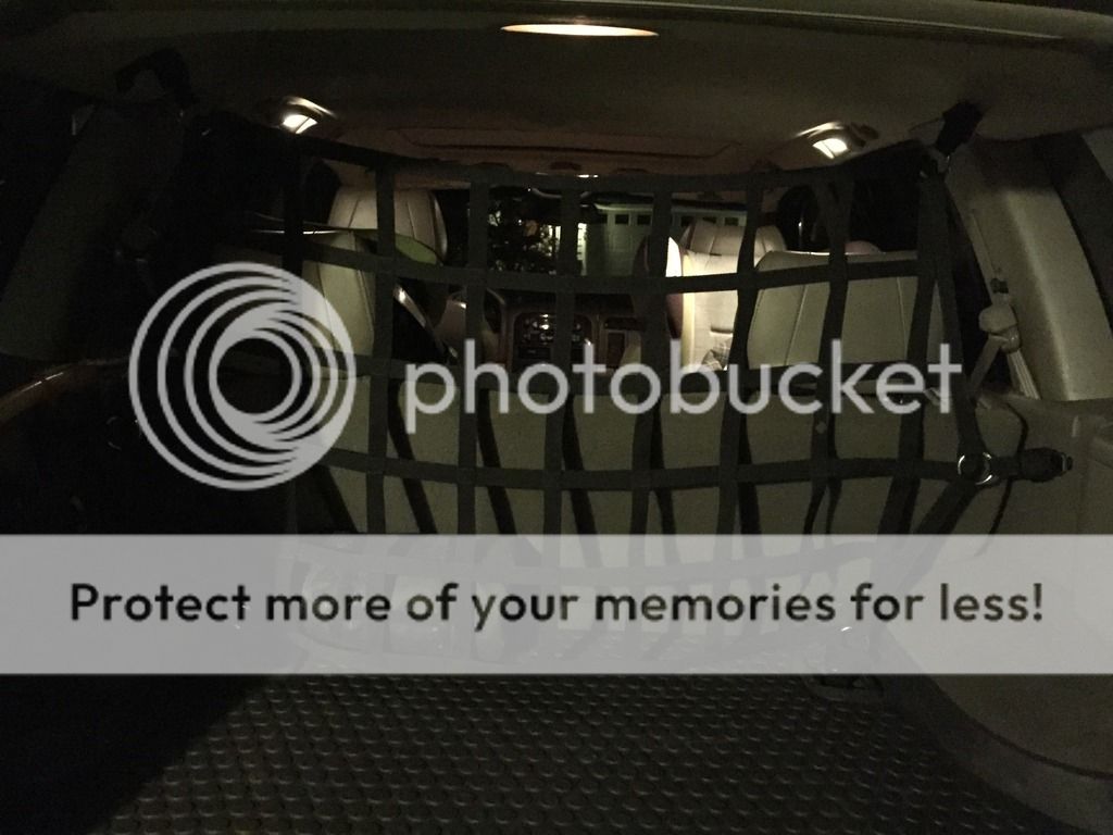

First of thank you to @jordanbrooks for the motivation, I've done some odds and ends, with a couple of big projects in the works. First odds and ends. I installed gear loops in the ceiling of my cargo area so I could install the raingler net I used in my Xterra. Not a perfect fit but it keeps the dogs in the back and will prevent getting beaned with any flying gear if things get sporty.

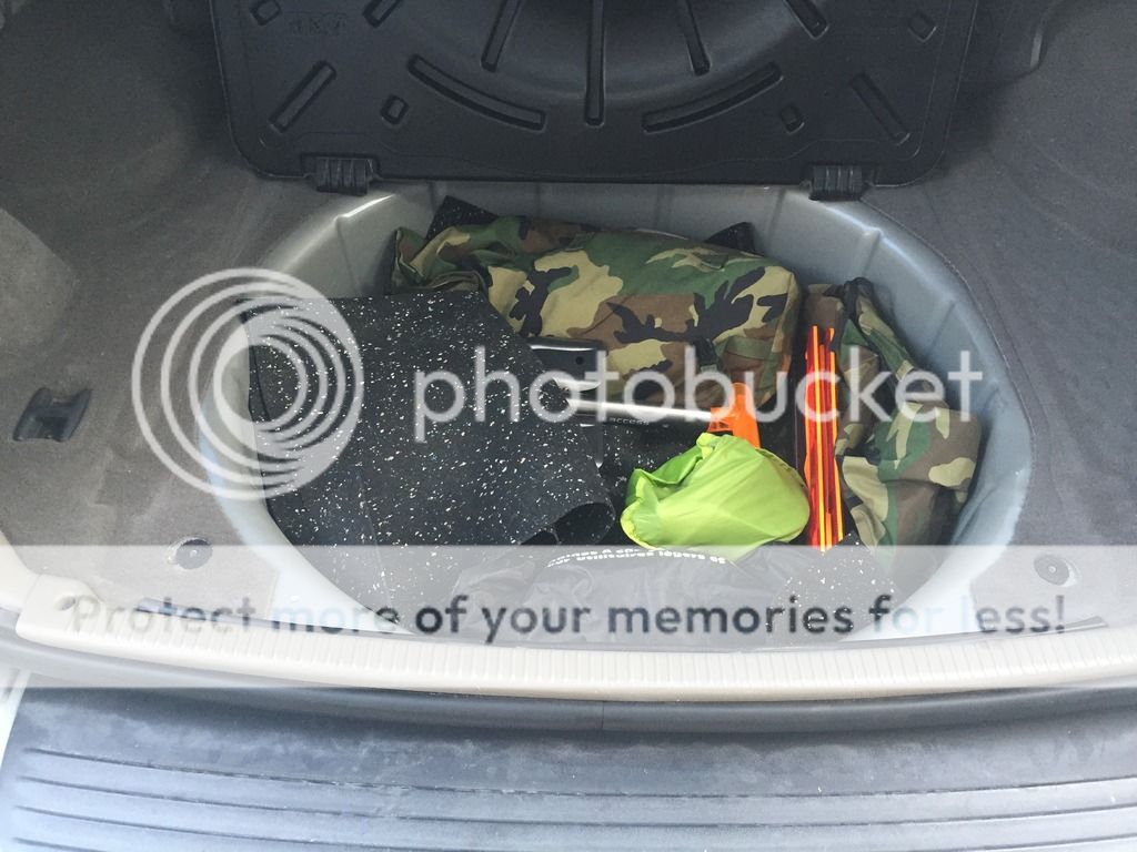

At some point i also filled the space under the cargo floor where the spare tire used to reside with all kinds of rig related gear, recovery straps, jumper cables, snow shovel, truck bag, ratchet straps, etc. Really convenient place to be able to store a lot of gear. I might end up installing a second battery in here when I go to a dual battery setup, haven't decided yet.

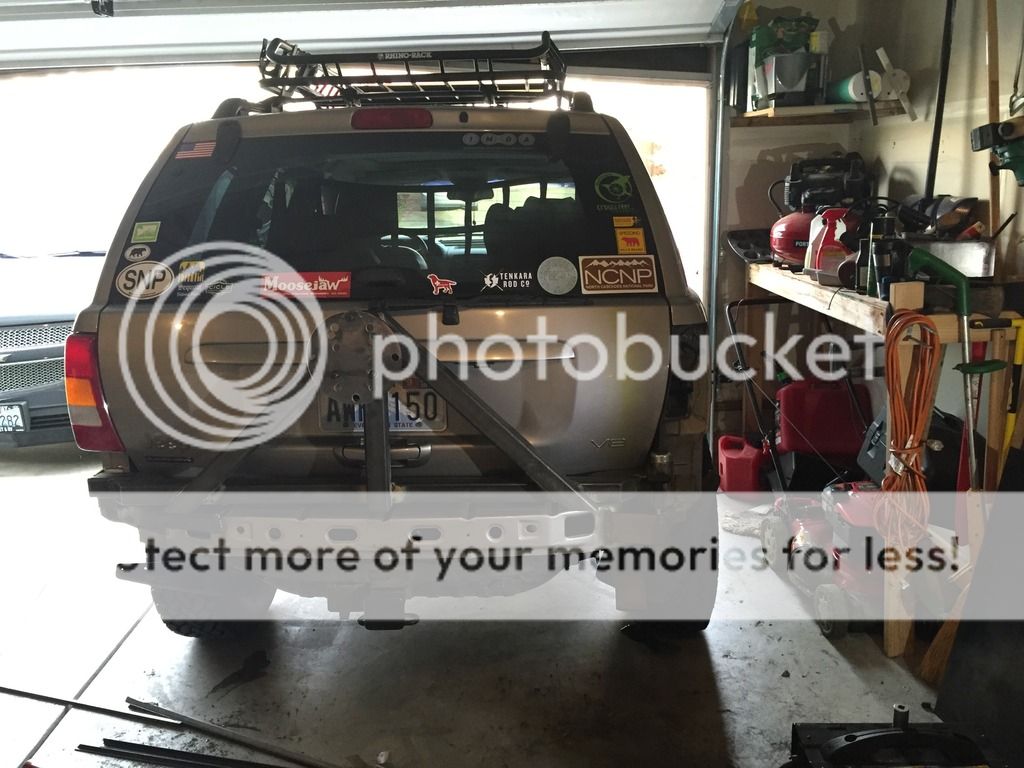

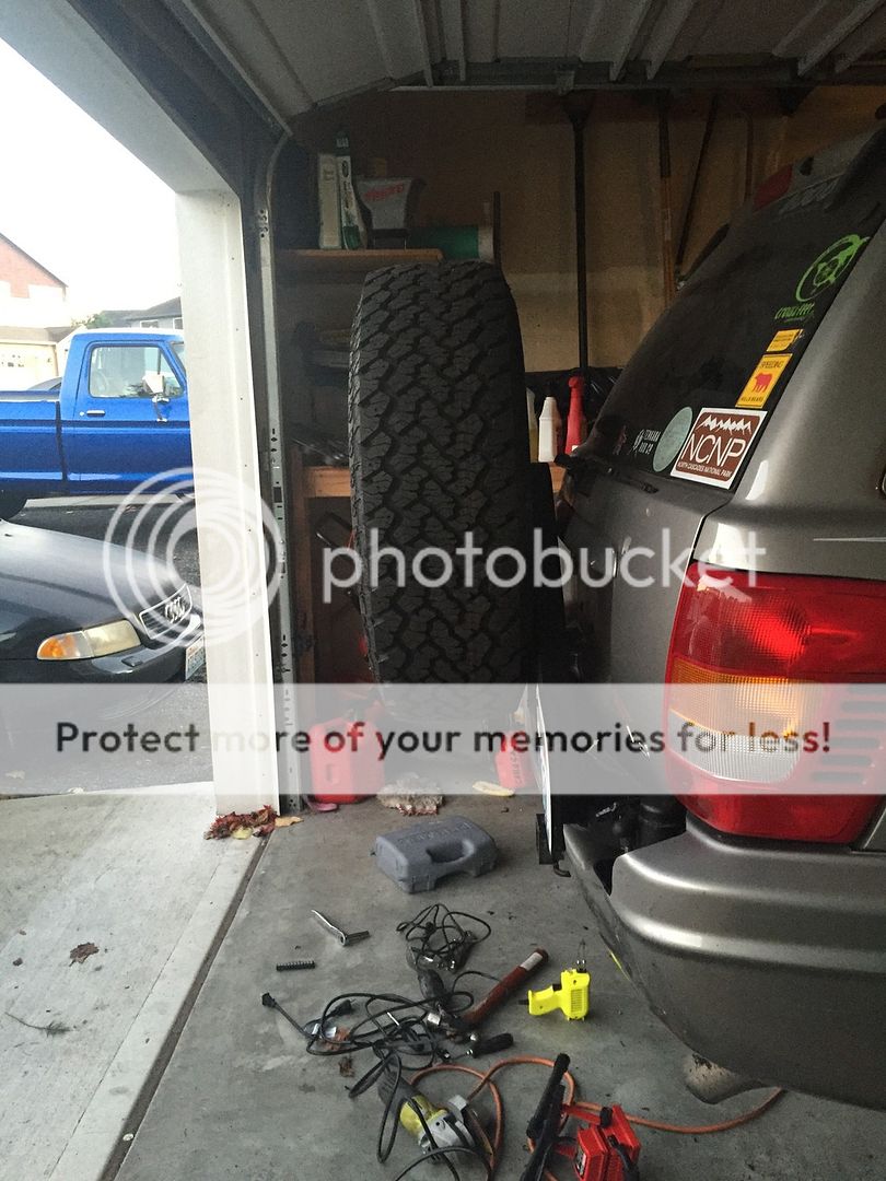

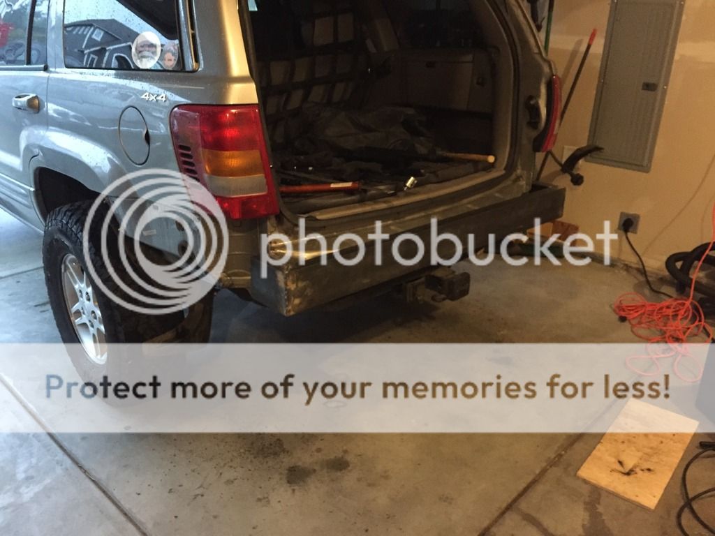

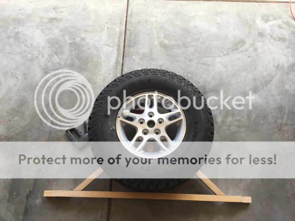

When I installed my lift and larger tires i also installed a roof top basket and used that for my spare tire. I knew when I did this that it would be less than ideal and I was right. The tire and wheel combo weigh in around 70lbs, having that much weight that high up added a significant amount of body roll to the Jeep. I looked at new armored rear bumpers with integrated swing gate tire carriers but they are really expensive. I decided to build my own swing gate tire carrier and integrate it into the existing body of the Jeep. The two main issues to this were that the rear bumper is completely made of plastic and supported by styrofoam so it couldn't support any kind of tire carrier. The other issues was that I didn't know how to weld. I picked up a pretty basic 170amp wire feed welder from Harbor Freight for under $200 that would do everything I would need. I pulled off my rear bumper to look at exactly what structural metal I had to work with and take measurements to start drawing something up. After I had my initial design, I built a mock up from wood to test fit it. I had decided I was going to use 2" square tubing for the tire carrier so I used 2"x2" lumber for my mock up. 2"x2" lumber is not actually 2"x2", its like 1.75"x1.75". I knew this but figure it wouldn't be enough of a difference to matter (I was wrong).
Picture of my mock up.

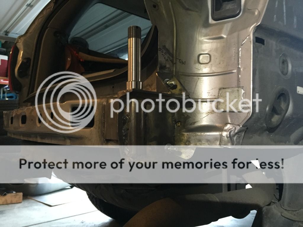

I ordered my hinge and tire carrier plate for A to Z fabrication(atozfabrication.com). I picked their mega spindle, it's rated for a 37" tire plus accessories and I am only running 32"s. I like over kill. This hinge is basically a 1.5" solid steel spindle with a could of bearing races machined into it and some thread cut on top. Its beefy, and the machining was top notch. It comes with two cartridge bearings, an outer 2.25" sleeve(that the swing arm welds to) a lower dust seal, a washer, a castleated nut, a cotter key and a top dust cap. The tire carrier plate is a thick plate with a bunch of holes drilled into to mount whatever wheel bolt pattern you have. I also bought 3 wheel studs from them while I was at it. Next I went to McMaster Carr and ordered my latch I picked a U-bolt pull-action right angle toggle clamp. It sounds really complicated but when you see the picture, you'll know what I'm talking about. The one I bought is made from stainless steel and rated to 1000lbs. I found a place online that sold metal called Metal Supermarkets that looked promising. They will ship to you, but they have 80 locations across the US and one was close. Not only did they have what I wanted in stock, they could cut all my pieces to order! This made the build way easier. They cut everything except for the round cuts for the hinge so all I really had to do was weld it all together. They could have cut the round cuts too, but I would have had to wait another couple of days. Now that I had all my parts and materials I started to figure out the welding part. Welding has always seemed kind of daunting to me. Something easier to screw up than not. I found this to be not true at all. My cheap Harbor Freight welder has a chart on the top that tells you how to set the welder for whatever you are welding on. Then I just had to ground the metal, point the gun and pull the trigger. It took a few tries before I figured out how fast to move the gun for good welds, but that was it. It is super easy. I was shocked and I can't believe how long I put off learning to weld. I should have done this years ago!

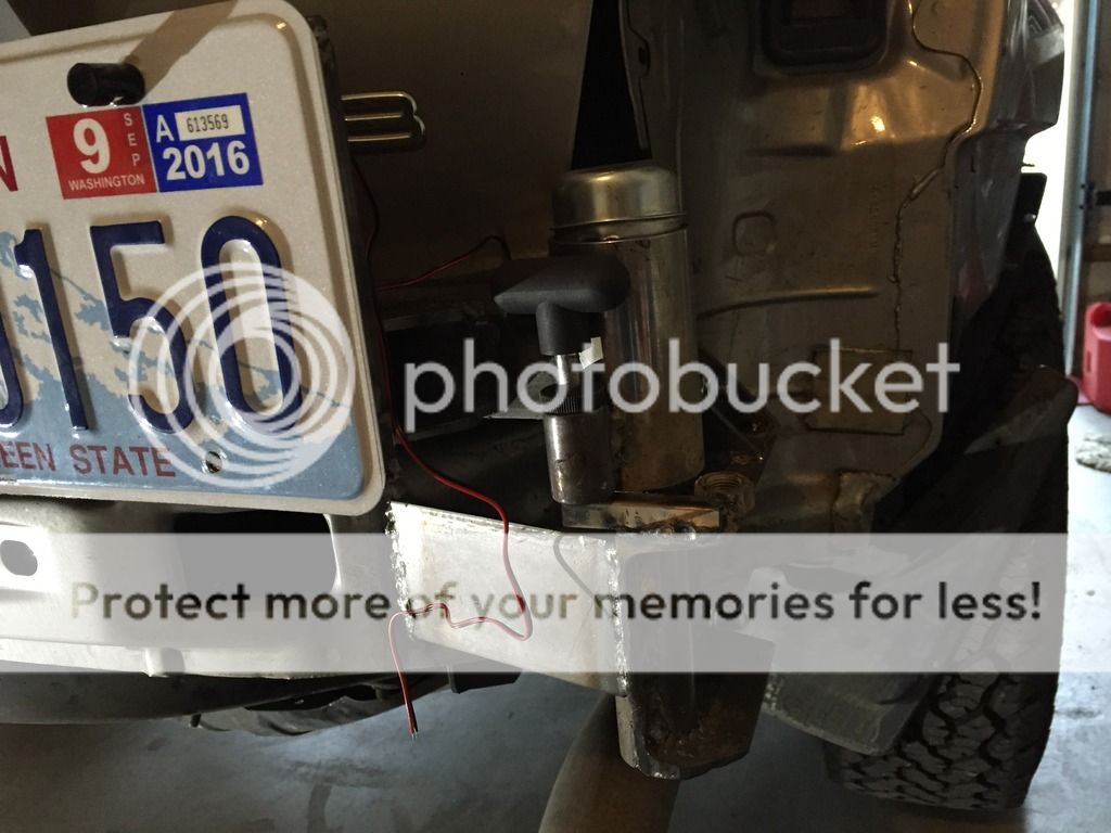

Now that I had everything I needed and all the skills I needed I started to work on the Jeep this is where I started to run into issues. The stock design for the Jeep has a large styrofoam insert between the plastic shell and the metal of the Jeep. My original plan was to replace this with a single piece of 5" steel "C" channel welded to the unibody of the Jeep. I figured this would give me good, solid support to mount the hinge to. I had the "C" channel cut at 45 degree angles on each end so I could weld two smaller lengths of it on to create a closed box with the back of the Jeep for greater support and rigidity.
"C" Channel installed.
The problem I ran into with this design was that the stock plastic bumper curved inboard and forward way more than I had thought and it wouldn't fit back on over the "C" channel. I came up with a new design I thought would work. It moved the mounting point in a couple of inches towards the front of the Jeep but the mock up still just barely cleared for this new location so I figured I was good. After some cutting on the chop saw I welded my new hinge bracket to the passenger side of the Jeep. I wasn't really confident in the holding strength of the welds though. The body seam I was welding to under the tail light is several layers of sheet metal welded together from the factory and the closest thing to a frame your can find on a unibody, but being that it is just sheet metal it was burning away from the much thicker "C" channel as much as it was welding to it so I drilled 2 holes and ran a couple of bolts with nuts and locker washers just to be safe.
Oddly the gusset I welded to the bumper support welded up just fine.
Here is the new hinge bracket installed with the hinge spindle installed too.

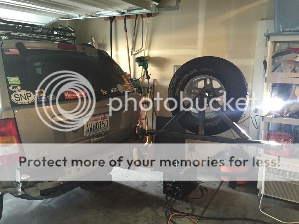

I moved on to the swing gate its self. Like I said earlier this was all going to be made out of 2" square tubing. It had all been precut except for the two curved cuts I made with my angle grinder to mount up to the hinge. It went really quick and easy. Once it was done I installed it to check fit and it hit the lift gate! The .25" difference between the 2"x 2" lumber and the 2" square tubing was enough to make it hit! This was easily fixed with the angle grinder but it was still annoying and time consuming.
Picture of an early test fit.
Now it was time to work on the details. I had been planning this for so long I had time to think up extra stuff I wanted like some brackets for auxiliary lights, a fold down table and a shovel mount. Not to mention I still needed a bracket for my license plate. So I fabbed up all of that, except the shovel mount, which I still havent figured out. Once the details were done I cleaned it up with a flap disk on my angle grinder, primed it with spray can primer and painted it with spray can truck bed liner. It's not my best paint job, it was colder than I would have liked when I was painting so it didn't dry as nice as I was hoping. I might fix it in the summer with better weather for such things. It's still not totally done though. The table mounting brackets are welded on, the table is fabricated, I still need to figure out how I'm going to latch it and support it though and I haven't figured out how to squeeze my shovel on with the table installed at the same time yet. Also in the future I would like to add a hi-lift mount. I tapped into the tail light wiring just above the hinge to run the Amazon sourced license plate light and was even able to run the ground and supply wires for my auxiliary wiring through the factory grommet for the tail light. All in all I'm really happy with the build. It cost about $400 for parts and materials and took probably 40 hours of total work over 6 weeks or so to get completed with the majority of it done in about a week. Trimming the plastic bumper was easy. I made the cuts with the knife blade on my leatherman and cleaned it up with a sanding drum on my dremel. I have some rubber sheet to install in both holes in the bumper to try and keep put as much water and dirt as I can. A few other details I left out of the narrative: there is a spring loaded latch on the hinge side to hold it open, I installed 2 18w Amazon knock off led light bar flood lights hooked up to a sweet Over The River and Through The Woods switch to light up campsites and trails, Impit some reflective tape on the latch end to hopefully prevent anyone from running into it at night and last but not least I turned my Overland Bound member badge into the center hub cap for my spare. I think the pictures below will cover most of the build.

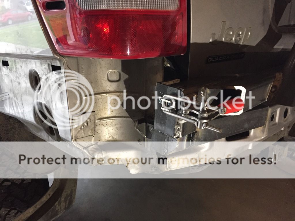

@jordanbrooks I used the mega spindle from A to Z Fabrication for my hinge, it was the beefiness I could find and I like our kill on projects like this. For the latch I used a U-Bolt pill action 90 degree toggle clamp from McMaster Carr. The latch is rated to 1000lbs, the pull action keeps the carrier nice and tight and rattle free, and is made from stainless steel so it won't rust. I also used a couple of pieces of hdpe on vehicle side of the latch to mitigate vibration and rattles. My biggest piece of advice is when you pull the plastic bumper shell off to make your plans, use the styrofoam absorber as a guide for your measurements. As long as all of your support structure fits inside the dimensions of the absorber it will fit under plastic bumper shell. Let me know if you have any questions on anything. I still have most of my measurements and what not.
