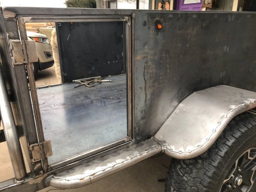

Had a very productive day! Got the sheet metal on flares and side runners. Bending to the radius of the tube was a mofo, and we didn’t get perfect edges on the side panels but it’s decent and will get filled before paint.
Also got door frames made and mounted as well as their inner seal mounts.
