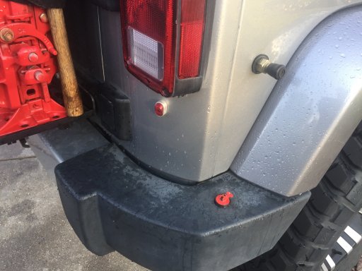

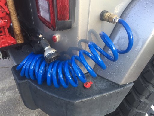

Noticed you have a Jeep wrangler. Another option you may have is a "Water Bumper". I live in Aransas Pass, TX (lived in New Mexico for 27 years)-I'm on the beach almost daily when I'm home. My Jeep is a 2015 JKU-the stock bumper is hollow. You can do what I have done and it works great. I use it to wash down my fishing rods, spray myself down, spray my wading boots off-also great for camping-washing dishes, etc. I installed a Shurflow RV pump above the differential, added reinforced tubing, a quick disconnect on the outside of the Jeep, filled the drain holes in the bumper, added a filler hole on the top of the bumper and plug and added the appropriate tubing fittings. Holds about 7 1/2 gallows, fantastic water pressure. The spray nozzle has shower, jet etc---and I'm sure it was a lot cheaper than the Road shower or Water Port water tank. Just a thought if you have the hollow bumper. I'm adding a New front bumper and winch over the winter-but I'm keeping the rear bumper.
When I have the Morris Mule Trailer hocked up I also have a system to run water to the rear of the trailer-works great.
If you need specifics I can send pictures and describe exactly what I did--and the problems I had initially.

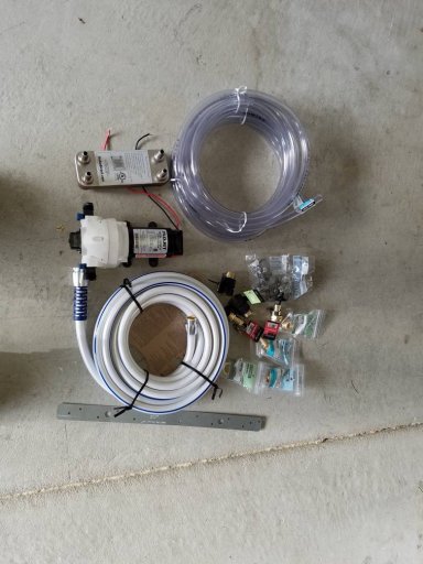

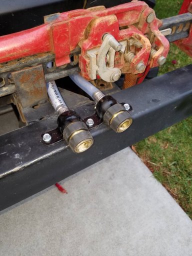

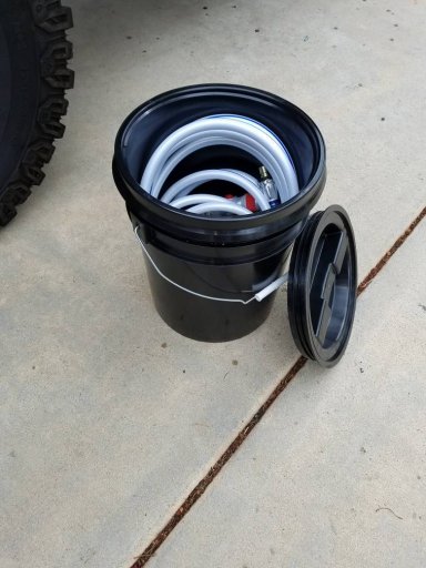

I sourced my own parts from Amazon and home depot. This all cost me $250 and took less than a day to install. You bypass the heater supply hose through the heat exchanger and use the pump to push water through the exchanger. I hold the hoses in a screw top 5 gallon bucket along with my soap.
It gets warm the first time through but if you cycle through the bucket for 45 secs it can get up to 120 degrees. Always has pressure and you can get 2 people bathed in 1 bucket.
