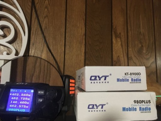

I also have both licenses, aside from the pair of Baofeng UV5Rs we use QYT KT-8900D (25w, 90$) in our trucks and a QYT 980PLUS (75w, 160$) for home
Pictured is an example showing, of course only in theory, that you could monitor both channels simultaneously. The Baofengs and the QYT radios also transmit on 2m, 79cm and GMRS frequencies.
This is not a recommendation or encouragement to do so. This is strictly for informational purposes.
