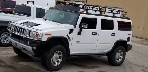

ArloTheH2
98
Kansas City
Haworth
21031
I've seen plenty of both off road. The all wheel drive H2 with front and rear lockers is very capable off road platform.
The H2's do have disproportionately small tie rods especially when people start throwing oversized tires on them. Most you see off road have stronger aftermarket steering components.
