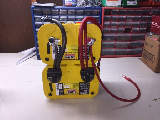

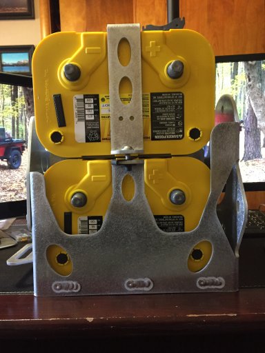

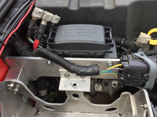

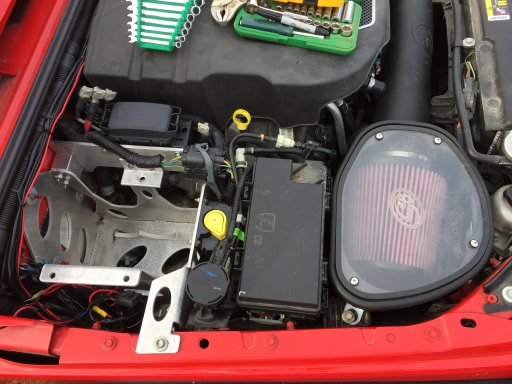

I am in the process of building a touch panel relay control system and am starting from scratch. I don't like the ones available on the market because of how I want the system to work. Picky, I know. I have figured out that I can use a Raspberry PI computer to control the custom relay system that I am also building from scratch. One problem, I don't know how to program. Anyone out there already have code that I could beg/borrow/steel already setup to do this? I have enough experience that I can figure out how to manipulate code (kind of) but not enough experience in actually writing it. 20 years ago I would never have imagined that this old fart would be integrating programming into building a rig. Who knew... Thank you in advance everyone! I've attached some pix to show the beginning of the system. What you don't see is the automatic switch that disconnects the batteries from each other when the voltage gets too low. This will allow me to maintain a starting battery and let me run the other batter all the way down if I choose to.

I suspect the Raspberry Pi can't source enough current or voltage on a GPIO pin to directly drive a relay. If that is the case then you could use the GPIO pin to switch a transistor, and then use the transistor to control the relay.
Or you could by a board already setup for this, it depends on how large of a relay you need.
