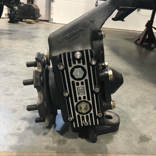

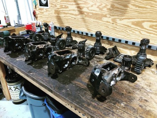

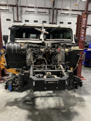

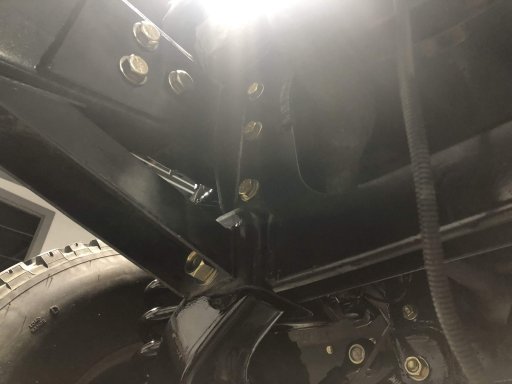

Step 2: Figure out everything that needs to be repaired, replaced or refurbished. With 150k hard miles on it and sitting in the yard for a few years there was plenty of work to be done. The entire suspension and drive train needed to be gone through carefully. The portal hubs and differentials where removed for rebuild or replacement. This is just the beginning. :tearsofjoy:

Step 6: Replace all fluids, filters, hoses, belts, batteries. Install a new 140v alternator, heavy duty starter motor, steering pump, water pump, custom coolant overflow reservoir, new cooling stack and just about everything in the engine bay except the engine. The engine was replaced under warranty somewhere close to 100k miles (after the engine block cracked in the Atacama Desert) so it's running pretty well. Rebuild the Central Tire Inflation System and install an ARB twin compressor to drive that and the ARB diff lockers front and rear. The goal was to make this mechanically as reliable as possible.

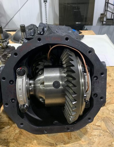

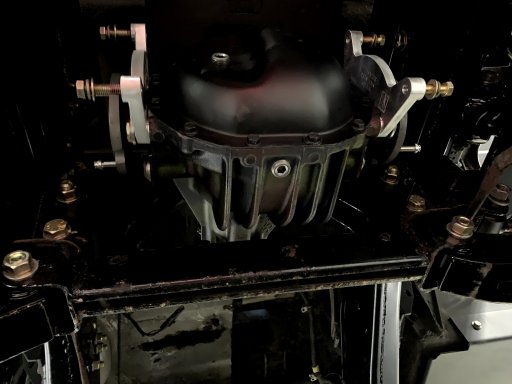

Next step: ARB lockers front and rear and Wilwood big brake kit. The truck had torsen diffs and a computer control traction system. Modern trucks have outstanding computer traction systems but this 20 year old military truck didn't have what you would call cutting edge tech these days. So I prefer the purely mechanical version and know when the diffs are locked or not. We also anodized the differential housings with a camo pattern to celebrate the military connection. My dad was in the Army so we picked green... his favorite color after his time in the Army... not.
The factory brakes where probably the worst thing on this truck. These brake should be a massive improvement. You'll notice in the pictures that the brakes are inboard right next to the differentials. They brake the half shafts since the portal hubs take up all the space in the wheels. It keeps them well protected from off road hazards and makes for extra fun when replacing pads.

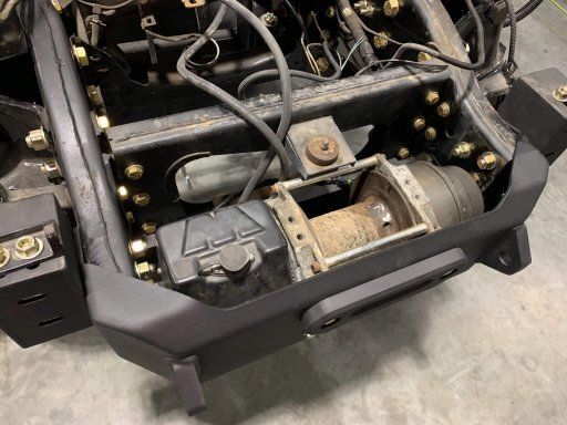

Adding a new custom winch housing / front bumper. This improves the approach angle just a bit over the factory version. With a winch the approach angle is about 50 degrees. I decided to keep the 12K lbs factory winch since is still worked well. We rebuilt it and replaced the steel cable with synthetic line. The truck still has plenty of "patina" in places... clearly the winch looks its age.
