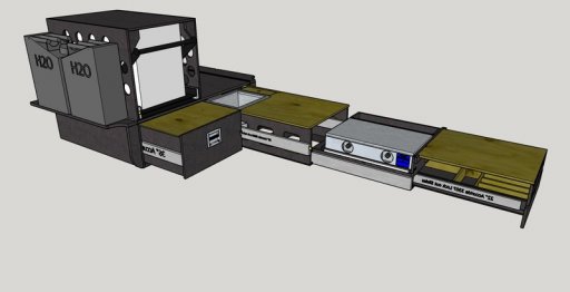

Like a lot of ideas, this one began with looking at what others have already done and deciding what fits best in my world.
Thankfully I have the tools and skills to customize and make this type of project. I'll likely skip the interior jerry cans but keep much of the rest. Probably shorten the length of the last segment. Overall- I like it.
It will be modular so I can take components all or none depending on the trip.
I've got a 2017 4Runner that this is meant for - Some of the large panel sides will have cutouts to reduce weight but keep structural integrity.

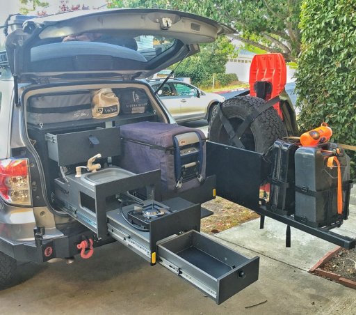

Pretty excited to have started my cargo area storage and kitchen build - I've come across many great examples and will be pirating components from each. Here is a picture of one I found recently - my design will flip the fridge and kitchen to the opposite sides and I'm not planning on a sink at the moment but may design it so that I could add one without too much frustration. One thing I am realizing is that if I ever go with a swing out spare/jerry can set up I'll need to find/fabricate one that pivots from the driverside as a single swing OR potentially a split set-up. I want the awning/camp side to be on the passenger side. Actual pictures of my build will come soon.cargo drawers and kitchen.jpg .

Look forward to seeing this build. That one pictured is clean! I just don't have the space or tools to build one so I'm looking at Trekboxx. Love how clean theirs are.

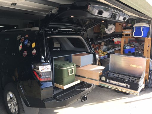

Well I'm pretty excited to have finished (aside from a couple little details) my cargo storage / kitchen.
I've been out with it on one trip so far and it did exactly what I was looking for. It allows for lots of space to both sides as well as a bit behind the rear seats, and a bunch above. Can't wait to get out there again with it.Kitchen slide.JPG
