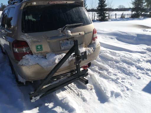

I got bored at work the other day and decided since the type of suv i have doesnt garner any aftermarket support in the way of bumpers id build a swing out rear tire carrier for it i purchased a 5x114.3 trailer spare tire mount from amazon and a 2" hitch extension from princess auto. Then i fired up the band saw and this happened

Nicely done. I was just looking at some for sale for $825. I might have to put this on my to-do list. Good work!
