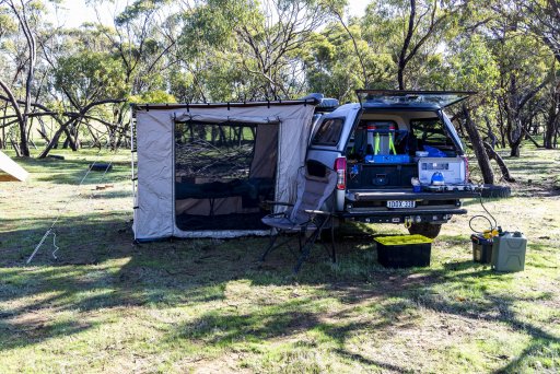

I have twin drawers with the fridge on a slide on top - the slide is a drop down version.
You have to take in height considerations if you want to put the fridge on the drawers, hence why I went the drop down slide so the wife could get into it.
With the slide out it still sits about 5 cm above the rear tailgate so at times the wife has to get a small step ladder out to reach into it.
The slide costs about $800 AUD so not sure what it is in USD.
